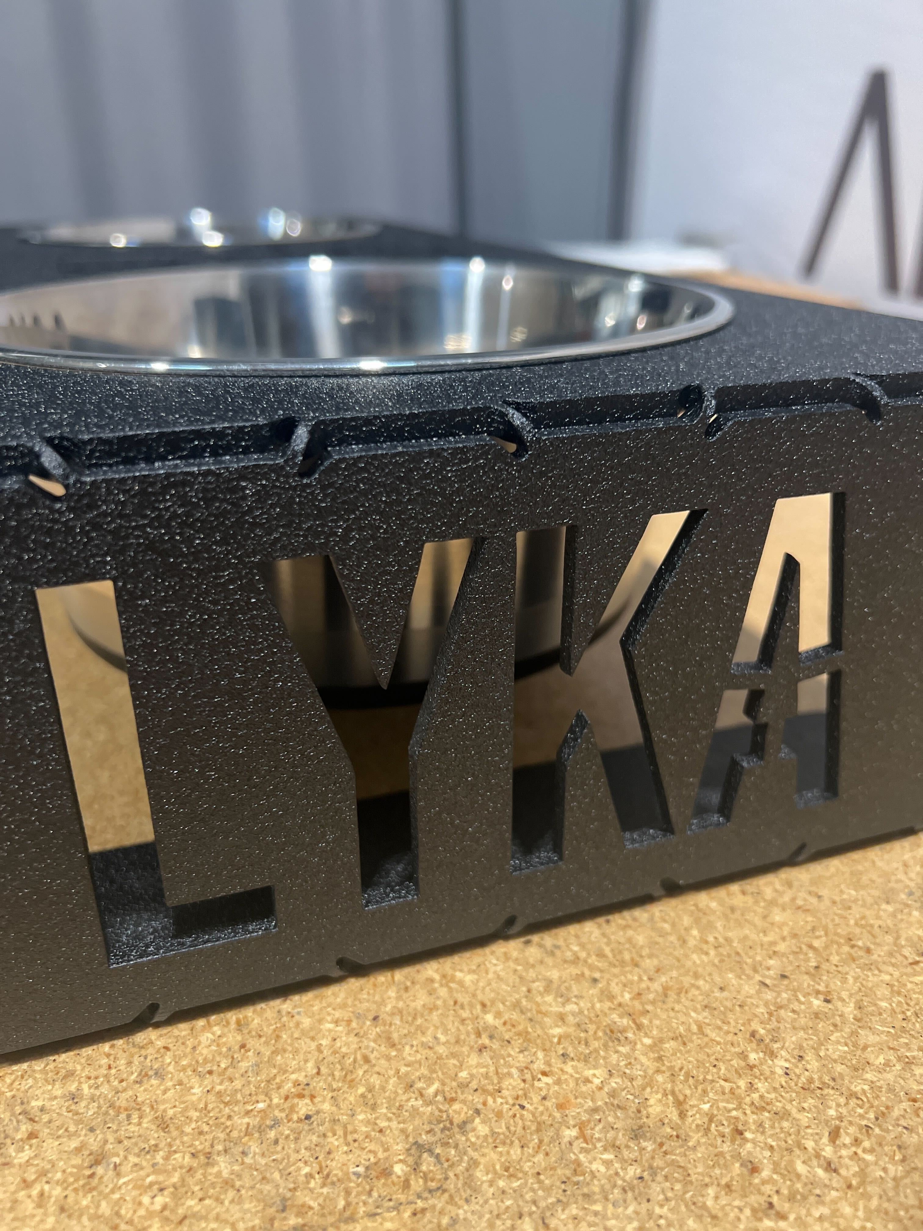

I recently used SendCutSends recommended cut pattern to make hand bending of sheet metal possible. I really love the results. The only downside is that the sketch took a fair bit of work to layout and update. I was wondering how hard it would be to create a custom feature script to set the necessary parameters and create the sketch entities. You can read more on the ScS website here.
