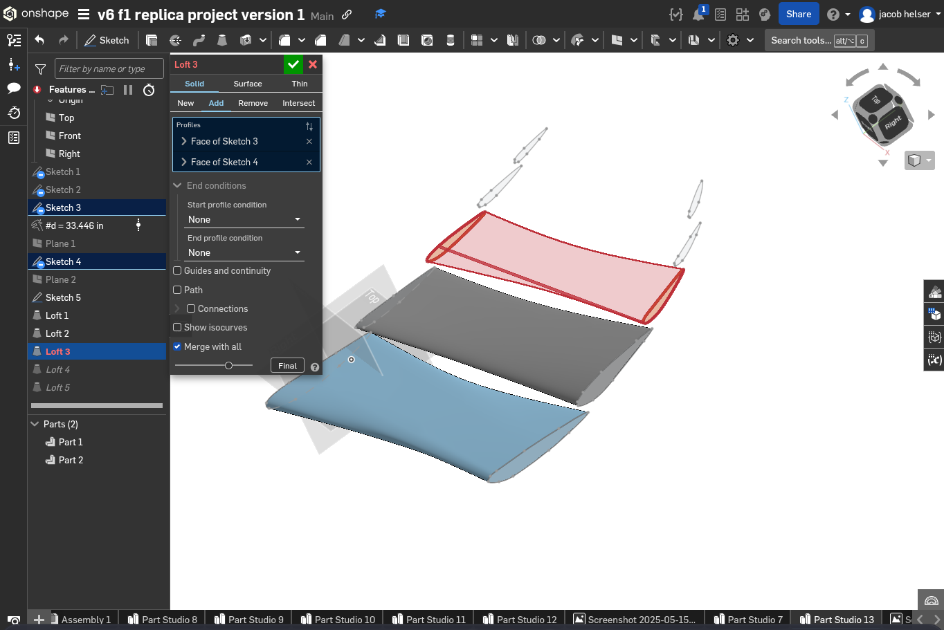

can someone tell me why this loft doesn't work?
  • Matt_Shields
    might need to check "Connections." Also, maybe use New, not Add.
  • MDesign
    edited August 2025 Answer ✓
    while not required it might help, when possible, to try making sure your profile sketches have the same number of connected points/segments… and the connecting points located in a similar proportionate fashion.
  • Matt_Shields
  • jacob_helser127
    jacob_helser127 Member Posts: 4 EDU
    that seems to help but still doesn’t work all the time just messed around with some of the connections
