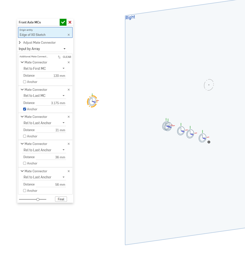

Create a linear stack of mate connectors at distances relative to the first MC, the last MC, or the last "Anchor".
Can't figure out how to name each one individually in the Features List.
But the relative positioning has been helpful for me.
