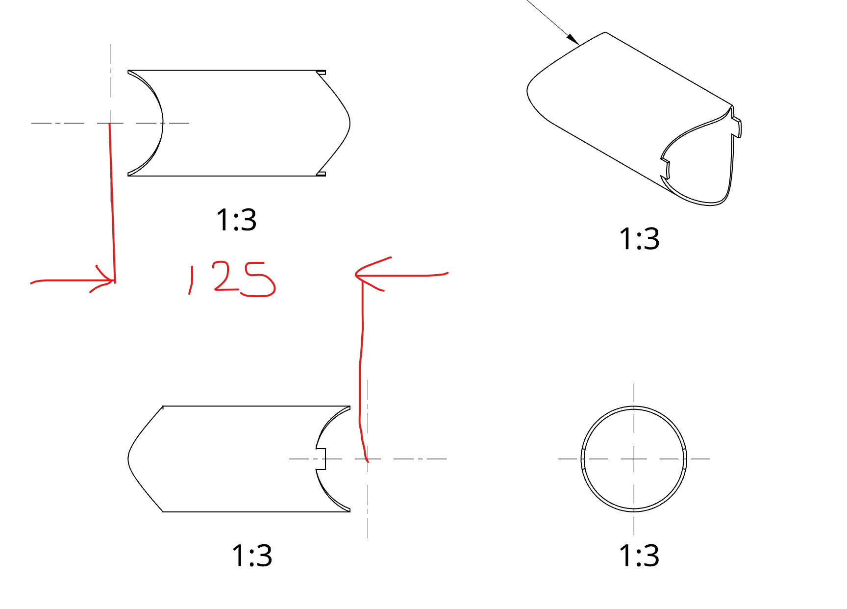

Dimension between projected views
Can anyone tell me if this dimension is possible to annotate?
Not important for this instance but it's not the first time I've needed it so it spurred me to ask.
An other option is to add and display sketches in the part studio that can be dimensioned.
@rob_relva We don't dimension between views as that gets sort of strange for view movements, view rotation, view scale events, etc…
You could create a composite part in your part studio of this scenario, then add a view for the composite part and dimensions the bodies in the composite part view.
1 -
perfect, never noticed that before thank you!
