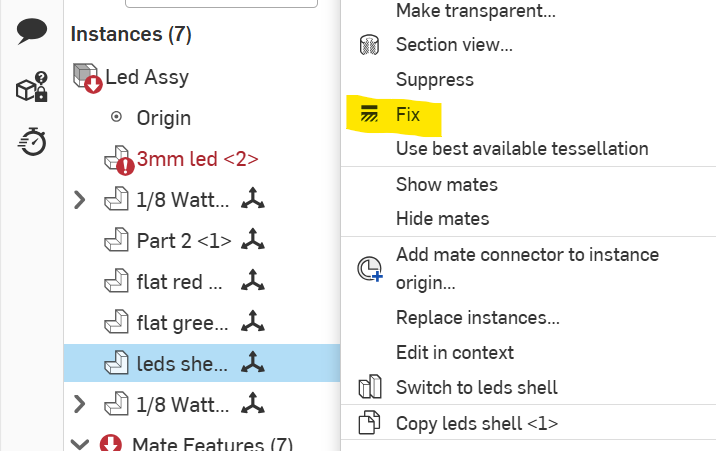

Hello,
I’m working on an assembly and I’m having trouble keeping one part fixed in place.
When I use the "Lock at current position" option, I can still move the part on its own, and it even shifts when I add mate features with other components.
Can anyone explain what the lock actually does, and how I can properly keep a part fixed ?
Thanks in advance !

  • robert_scott_jr_
    Hello Benoit.
    In an assembly, right click on a part to bring up a menu. Within that menu select Fix. - Scotty
  • benoit_maurel
    benoit_maurel Member Posts: 18 ✭
    Hello Robert,
    Thank you for your answer !
    That doesn’t really work in my case because I want to fix an assembly itself.
    To give you some context, my assembly is made up of multiple sub-assemblies, and I want to fix some of them.
  • glen_dewsbury
    Using fix more than once will give a warning message if that matters to you.
    The sub assemblies can be built with mate features applied or if no moving parts it can be grouped. One part should be fixed in each sub assembly as well to keep position steady.
    Then mate them to the main assembly.
    If your going to build other parts around or in between the sub assemblies then use a mate connector with offsets and rotations as needed to set initial position.
  • benoit_maurel
    edited August 2025 Answer ✓
    Okay, thank you for your help.
    It was, in fact, not possible to do exactly what I wanted, but I had also forgotten to fix at least one element in the main assembly (I’ve now created a fastened mate with the origin).
