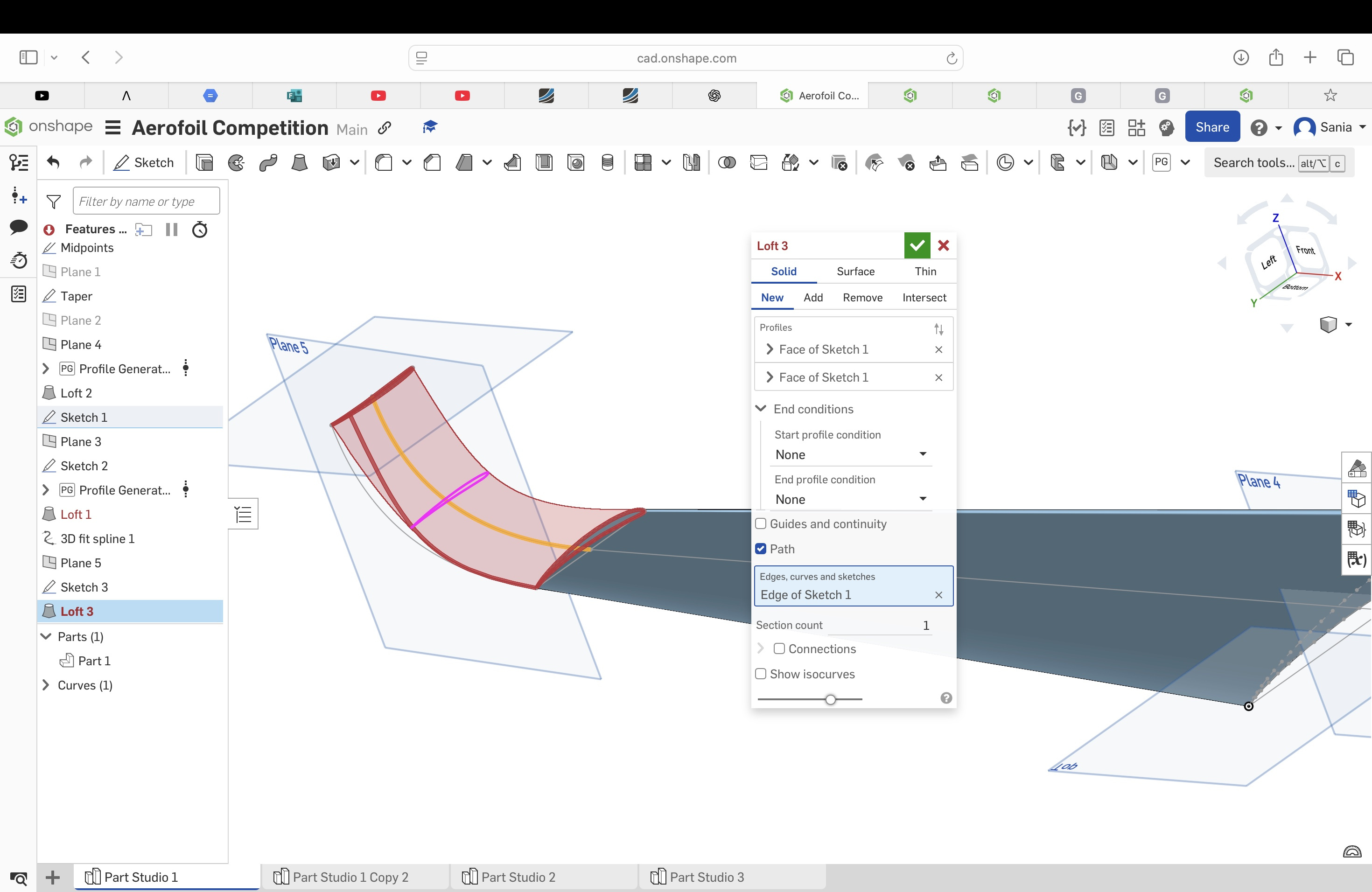

Using loft to create a winglet
sania_dhawan
sania_dhawan Member Posts: 2 EDU
I'm trying to use the loft feature to create a winglet by connecting 2 different aerofoil sketches (1 bigger than the other), any ideas why it isn't working?
  • MDesign
    looks like your profiles have a different amount of vertices. Use the connections option in the loft to tell Onshape exactly which points should connect to which.
  • martin_kopplow
    As MDesign already said. But be super careful. This simple loft approach is very likely to not create the exact intermediate airfoils you expect. If you're after performance, you'll need a bit more helper geometry.
