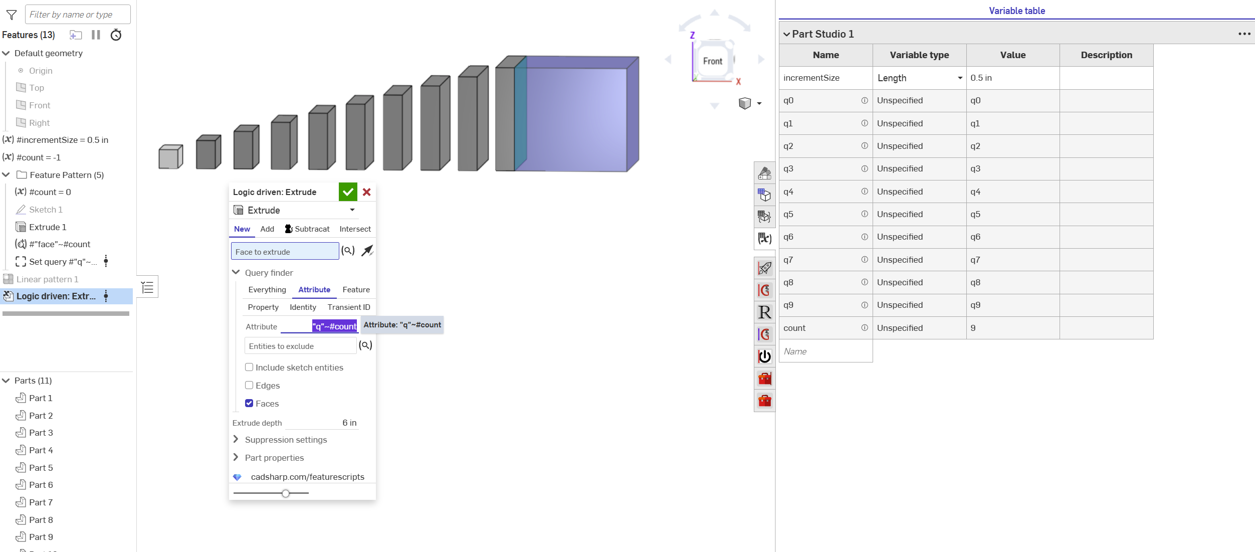

    S1mon Member Posts: 4,609 PRO
    More what I'm thinking is that instead of - to take a really basic example - patterning an offset plane with a feature pattern, I was to generate a list of offsets, and then feed that into a plane feature.
    This obviously doesn't work yet, but something like:
    In my example above, I would manually generate the list of dimensions, but ideally, we'd have tools like Range, Series, and Sequence (and well beyond that) from Grasshopper:
    https://grasshopperdocs.com/components/grasshoppersets/range.html
    https://grasshopperdocs.com/components/grasshoppersets/series.html
    https://grasshopperdocs.com/components/grasshoppersets/sequence.html

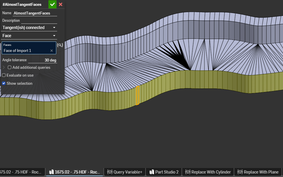

    edited August 2025
    Now that I've tried query variables briefly, a few thoughts:
    I'd really like to be able to create a query while I'm in a feature - just like I can create a variable on the fly in other contexts. One difference with @EvanReese 's Selection Fillet is that you can live preview not just the edges, but also the result. Of course with the [Final] button and a fillet feature in place after the query variable, you can simulate this, but it's not quite as immediate. Perhaps this is coming in the future?
    Within FeatureScript I've managed to get sketch points from a sketch as a query without selecting the vertices of other lines in the sketch. I couldn't quickly figure out how to do that in the query variable.
    I hope there are more query variable videos coming in the future. Building queries is really powerful, but it will definitely take some learning.
    I was very happy to be able to do something I've been wanting a lot lately: parametrically pick edges of a sheet metal model to add corner breaks to. I was surprised to see that one of my queries (#inside_corners) didn't work unless I evaluated it on use (or just move it right before the second Corner break).

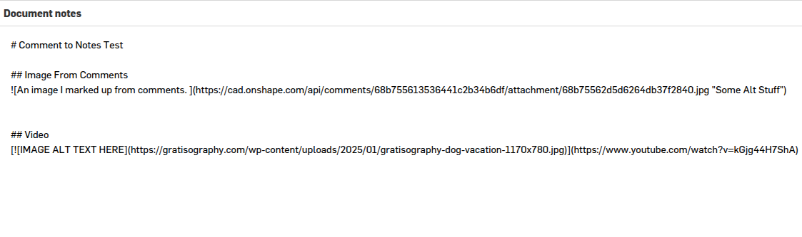

  • Henk_de_Vlaam
    Henk_de_Vlaam Member, Developers Posts: 269 ✭✭✭
    Besides the Query variables, the Document notes are also awesome. Now you don't necessarily need the Link Tab Utilities app anymore because URLs are recognized in Notes and therefore active (sorry @lougallo ). However... a Link Tab is always visible and therefore indicates a URL, whereas Notes doesn't. As long as you don't press the Note button, you won't see that a note exists. That's why I posted an IR requesting an indicator.
    This is the link to the IR:
