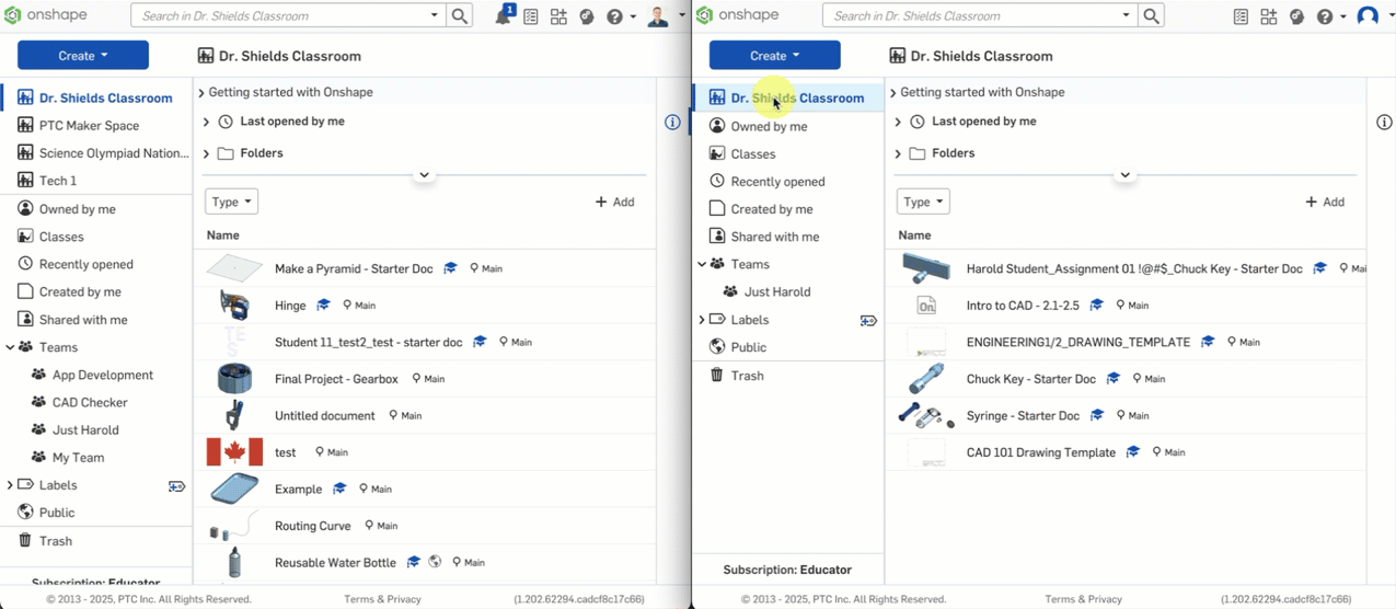

    Maybe the animation below will help clear things up. On the left you see the Educator, the owner of Dr. Shields Classroom. Harold (on the right) has access to all documents explicitly shared with the Classroom (just 6 documents). You can see that the educator has access to all of the documents in the classroom. Harold also has access to documents shared with the Just Harold Team, but none of the documents shared with "My Team."
    By the way, the reason you're seeing more than one Classroom for the Educator on the left is because other Educators have added him to their Classrooms.
