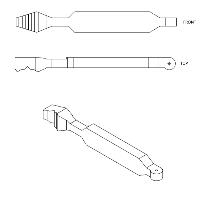

Hi, this is my first full project in Onshape. I’m still very much a beginner, and my goal is to turn a vacuum into my favorite droid — R2-D2 from Star Wars.
Right now I’m stuck trying to bend one of R2’s arms and could really use some advice.
At first I tried using projected curves, but I found that both the top and front profiles weren’t simple enough to just project — I had to sketch them out manually. From those sketches I built a 3D part, and now all that’s left is to bend it.
The problem is, I can’t figure out how to do the bend properly because the part doesn’t have a single straight face to work from.
Here are a couple images of what I’ve got so far:
And here’s the link to my Onshape document if anyone wants to take a closer look:
Has anyone run into this before or know a good way to approach it?
I am open to any ideas, even if that means starting over

your other answer is you can’t bend it. You have to model it bent.
@MDesign thanks for the direction, I am having a little trouble in doing so.
You see, at first I just had the front face, I used 2 curves and projected that face to two planes connecting them into one face or maybe even with lofts (I am not entirely sure about which one, I think I tried both)
Then i found out that the top sketch had to be made, which lead me on a tangent that i now have the current top sketch, which is the exact one that broke my brain.

You're link to your document doesn't seem to be working. If you can get that to work maybe myself or others can see what your trying to do.
Ah you are right, the link to the version I think was best effort is: https://cad.onshape.com/documents/2b69383e752cebbf3da693b9/v/d594719a7b1cd5dbe606cccb/e/8b1bbebb210eac9fc9dc9390?showReturnToWorkspaceLink=true
Based on this image in your document…It looks like a simple extrude will capture most all of the curved features. Then you'd just need to work out the opposing cuts/angles to get the rest of it. Red represents what might be the first extrude feature., pink a hole feature. and blue a circular pattern feature.

That thing is sure milled as is. Why design it straight and virtually bend it, when it is not even manufactured by postforming?
