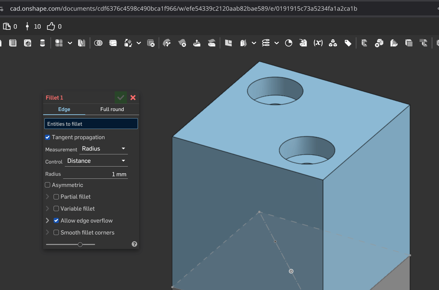

unexpected selection behavior when filleting the results of a self-repeating custom feature
kyle_altendorf
kyle_altendorf Member Posts: 75 ✭✭
i'm not quite sure what to make of this. the lower-right hole is the one based on the first item i selected for my custom feature and that seems to be relevant here, and in other cases where i ran into this with the same feature.
clicking the edge of the first instance selects both instances. deselecting the first does not deselect the second. while both are selected from the single click, it shows a single entity selected in the list. etc… i assume i've written a bug in my script, but i wouldn't have expected to be able to do this and i'm not sure what i'm doing wrong with the ids.

    The entity ID's are getting confused. Looks like your loop is a little strange. Try to use just a standard for-loop and do not use in-line functions for starting out in FeatureScript:

    thanks for the suggestion. i know i have a couple other inline functions i should reconsider, but i had thought that forEachEntity() was the proper way to get the looping ids handled well relative to the original entities i was building from. to confirm, forEachEntity() should not be my default pattern for this? it seems like a simple loop with i as the id modifier would be somewhat non-unique in the sense that created features will have ids based on simply the selection order and not the original entity they are built from. this could result in downstream references pointing at the wrong entities if the selection passed to my feature is changed, when instead it might be better for the downstream references to break than to reference the wrong entity.

            for (var i = 0; i < evaluateQueryCount(context, definition.locations); i += 1)
                const entity = qNthElement(definition.locations, i);
                const id = id + i;
    this was a slightly different route than your exact code, but the same idea and it does indeed avoid the issue. i guess i'll print out the ids in both cases and try to better understand how my use of forEachEntity() is wrong. then maybe figure out how that doesn't trigger the id reuse error either. thanks again.
  • kyle_altendorf
    forEachEntity() is ok if i disable my cleanup code at the end. i knew my cleanup was a hack.

    i still haven't quite figured out the underlying issue, but moving my cleanup outside of the forEachEntity() call and using the code below seems to both have the effect i want of not showing the sketches as well as avoiding the shown selection trouble.
            const toCleanup = evaluateQuery(context, qCreatedBy(id, EntityType.BODY))
                ->filter(function(body) {
                    return evOwnerSketchPlane(context, {"entity": body}) != undefined;
                ->qUnion();
            if (evaluateQueryCount(context, toCleanup) > 0) {
                opDeleteBodies(context, id + "cleanup", {
                    "entities" : toCleanup,
    i'll clean up my code and post a new working version.
  • kyle_altendorf
    https://cad.onshape.com/documents/cdf6376c4598c490bca1f966/v/f0e9920ccf50036003da5f7e/e/0191915c73a5234fa1a2ca1b?renderMode=0&uiState=68beffa2f38c870f00ec4c8d
    i simplified the cleanup down to a single call to this at the very end of the feature function and outside of the forEachEntity().
        "entities" : qSketchFilter(qCreatedBy(id), SketchObject.YES),
    thanks for getting me started down a useful debugging path.
