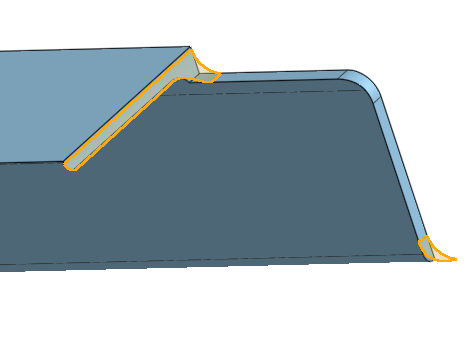

Hi,
when using the frames tool using angle steel I get funny results in the cut list when using limit frame ends.
The little extension from the subtraction of the two profiles leaves the cut list pretty much useless.
Is anyone else having trouble with this?
  • wayne_sauderwayne_sauder Member, csevp Posts: 629 PRO
    This is why I rarely use the up to part option. Often, you can avoid this by using up to face.
  • TinusTinus Member Posts: 6 PRO
    Unfortunately it is not possible to trim to multiple faces for one end. You end up with overlap, but the overall length ends up correct.

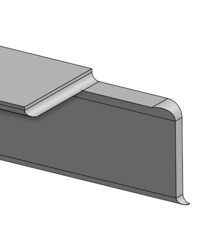

  • MDesignMDesign Member Posts: 1,265 PRO
    You could use the delete face tool on those two rounded area to get a "real" cut. The length in the cutlist is updated with that change.
