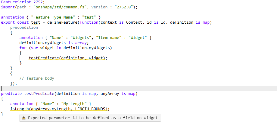

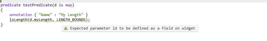

The predicate doesn't recognize the input map unless it is hard-coded with the same name "widget". Is there a trick to getting this to work? One that doesn't involve hard-coding the map name into the predicate?
FeatureScript 2752;
import(path : "onshape/std/common.fs", version : "2752.0");
annotation { "Feature Type Name" : "test" }
export const test = defineFeature(function(context is Context, id is Id, definition is map)
    precondition
        annotation { "Name" : "Widgets", "Item name" : "Widget" }
        definition.myWidgets is array;
        for (var widget in definition.myWidgets)
            testPredicate(widget);   // this is the only declaration
        // feature body
predicate testPredicate(d is map)
    annotation { "Name" : "My Length" }
    isLength(d.myLength, LENGTH_BOUNDS);

    interesting idea. I was able to get it to work but there are some quirks you have to work around.
    The var name MUST MATCH the map name in the inner predicate. And then if you want to have multiple uses in a single FS then you need to add a string variable otherwise it flags the inner predicate as a duplicate.
    precondition
    annotation { "Name" : "Widgets", "Item name" : "Widget" } definition.myWidgets is array; for (var widget in definition.myWidgets) { testPredicate(definition, widget, "0"); // this is the only declaration } annotation { "Name" : "Widgets", "Item name" : "Widget" } definition.myWidgets2 is array; for (var widget in definition.myWidgets2) { testPredicate(definition, widget, "1"); // this is the only declaration } export predicate testPredicate(definition is map, widget is map, i is string)
    annotation { "Name" : "My Length" } isLength(widget["myLength" ~ i], LENGTH_BOUNDS);

    Predicates can take additional inputs. So you need to have both the definition as an input and the array item.
    Ex.
    predicate testPredicate(definition is map, widget is map)
    isLength(widget.myLength)
    and then just call it inside the array as you are expecting, but with both definition and widget
    Side note, definition cant be passed in twice, so a predicate only work in either array or not in an array, but not both.

    @Caden_Armstrong how is that technique different than what I was doing? It still requires the array name to be literal, hardcoded into the predicate, so there might as well not even be an input for the array map. It would mean that the predicate is useless unless all arrays are named the exact same which defeats the purpose of having a predicate like this.

    O and I guess one more edit to the above would be that you don't need to reference the definition in the inner predicate nor the export the predicate.
  • MichaelPascoe
    Ty for the input @tabetha_bulnes & @Caden_Armstrong. This is further than I was able to get previously. Seems like a type check "bug" or lacking implied functionality.
