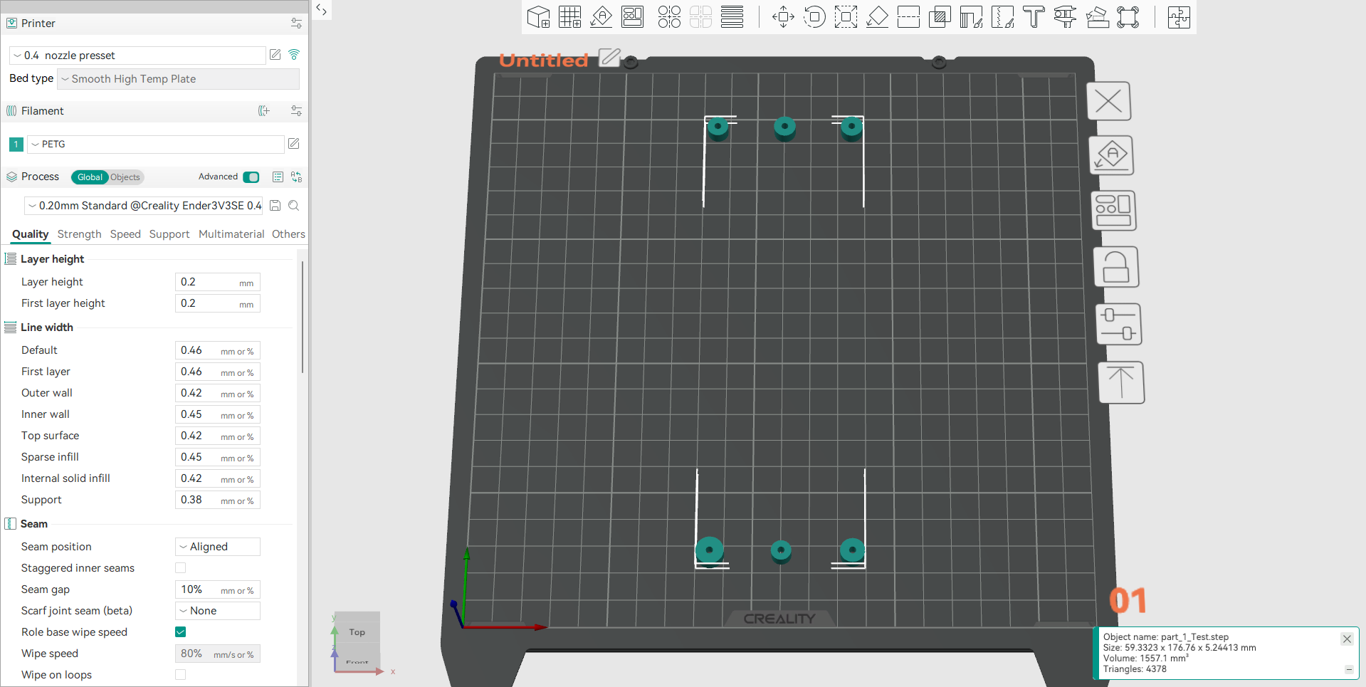

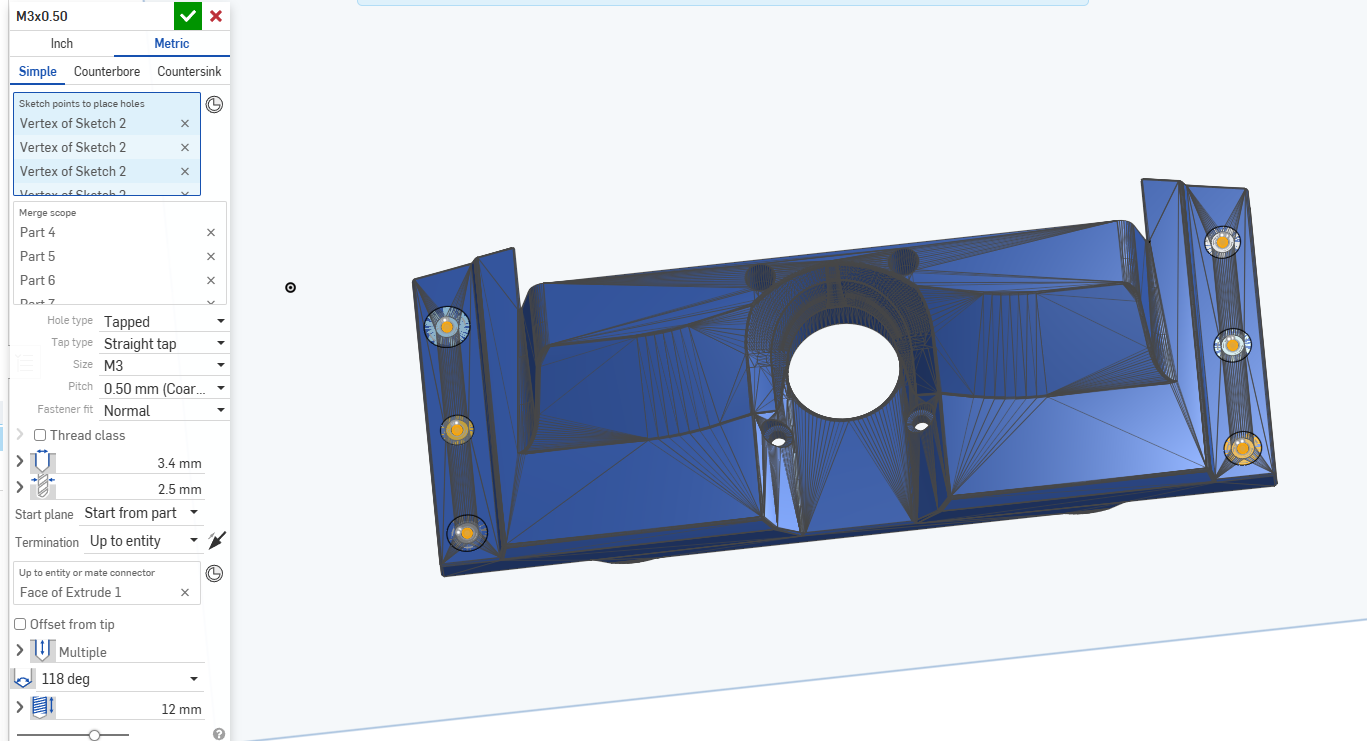

Hello, Im trying to export this mixed- mesh and solid part as STEP.
When loading it in the 3d view/slicer I can see only the solid parts and not the mesh…

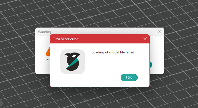

I also tried to export it as an STL, but I still need it in STEP, so after trying to reload it as an STL and export it as STEP, the whole model doesn't load up in the 3d viewer.
What can I do?
Thanks

    You don't need step for bambu slicer. but make sure you have the checkbox for exporting all parts as individuals turned off, or make sure it is all one part with boolean or merge operations

    I need it to be step for factory to be machined
  • S1monS1mon Member Posts: 4,092 PRO
    I doubt that the vast majority of CAM programs can handle mixed mode models like that. You probably need to replace an all the mesh with regular surfaces.
