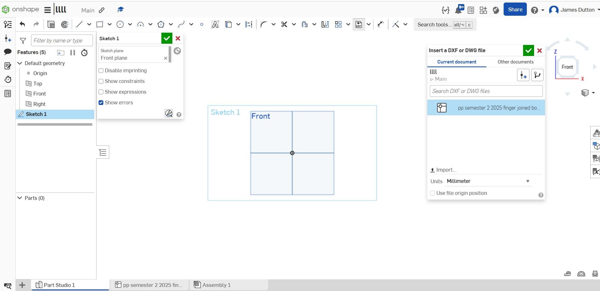

I am trying to import a dxf file into a part studio sketch, but when i click on the file (pp semester 2) nothing happens. I have a feeling this is an easy fix and i'm missing something obvious. Any help would be appreciated.
    S1mon Member Posts: 4,637 PRO
    Make sure you zoom out. Sometimes it imports, but way off in space, so it's not obvious. If still nothing is coming in, I would click on the DXF file tab and see what that displays. If there's nothing there, it may be an issue with the DXF file or how it was exported from the source.
  • james_dutton
    james_dutton Member Posts: 3 EDU
    Thanks for your reply. Unfortunately neither of those suggestions work. I've tried a few different dxf files and it's still not appearing in part studio sketch.

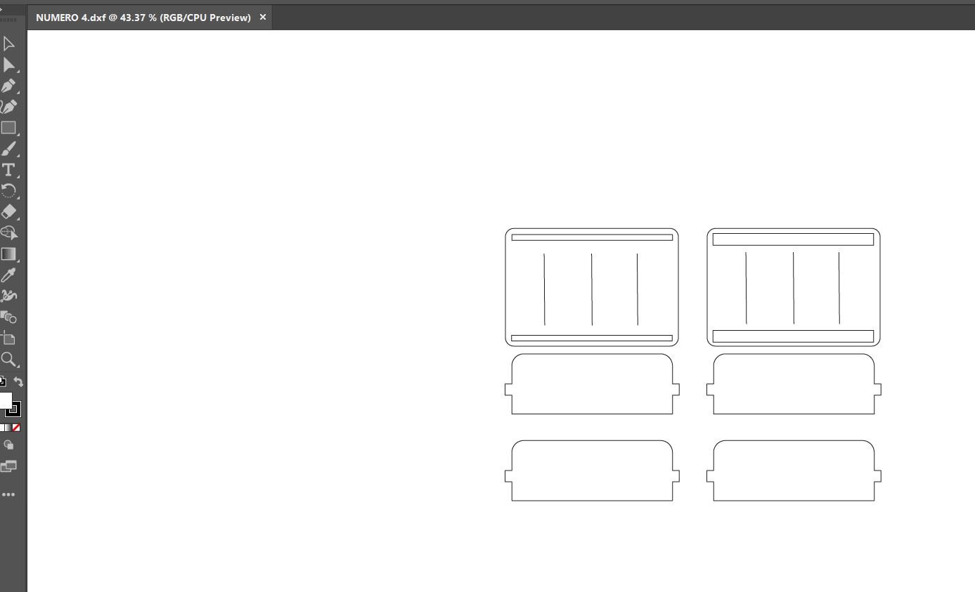

    can you post a screen shot of what the dxf is supposed to look like?
  • james_dutton
  • MDesign
    Seems like a normal file to import. Can you post a link to your document or provide the dxf for someone to try?
  • martin_kopplow
    Sometimes, in a DXF file, you'll find tons of layers, not all of them are part of the model, some are part of the sheet layout ("Model Space" vs. "Drawing Space"). Drawing space might not get imported in all systems. Then, the curves imported may be white and just not appear on a white background, or black … then, they're there but you just don't see them. Sometimes, the scaling is so far off that the're all only a tiny dot in space. Sometimes, DXF files have curves nested in blocks many levels deep. These do sometimes also not get resolved. And then, DXF is not a standard format, but subject to change with every new version Autodesk deem necessary, and third parties build their own dialects, some of which which no one understands, on top of it. Keep it simple and use an older well tried version to export.
