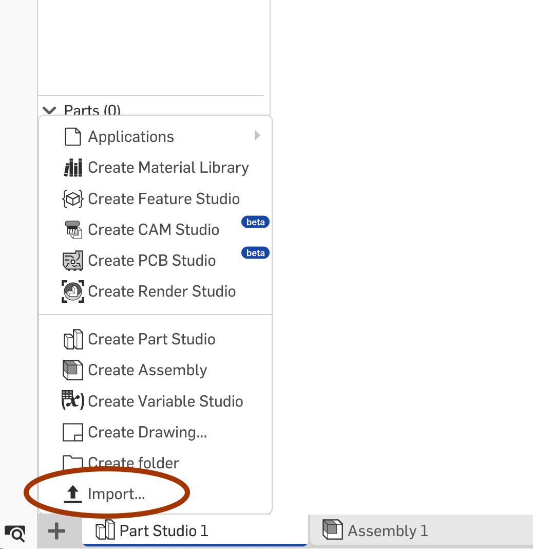

A customer sent me an stl file and I don't know how to upload it in onshape to see if it will work or not. I have some knowledge of cad systems but I have never used onshape. Please help

    If you go to the bottom left in a document and click on the + sign you will get this menu
    Select Import and follow the intructions
