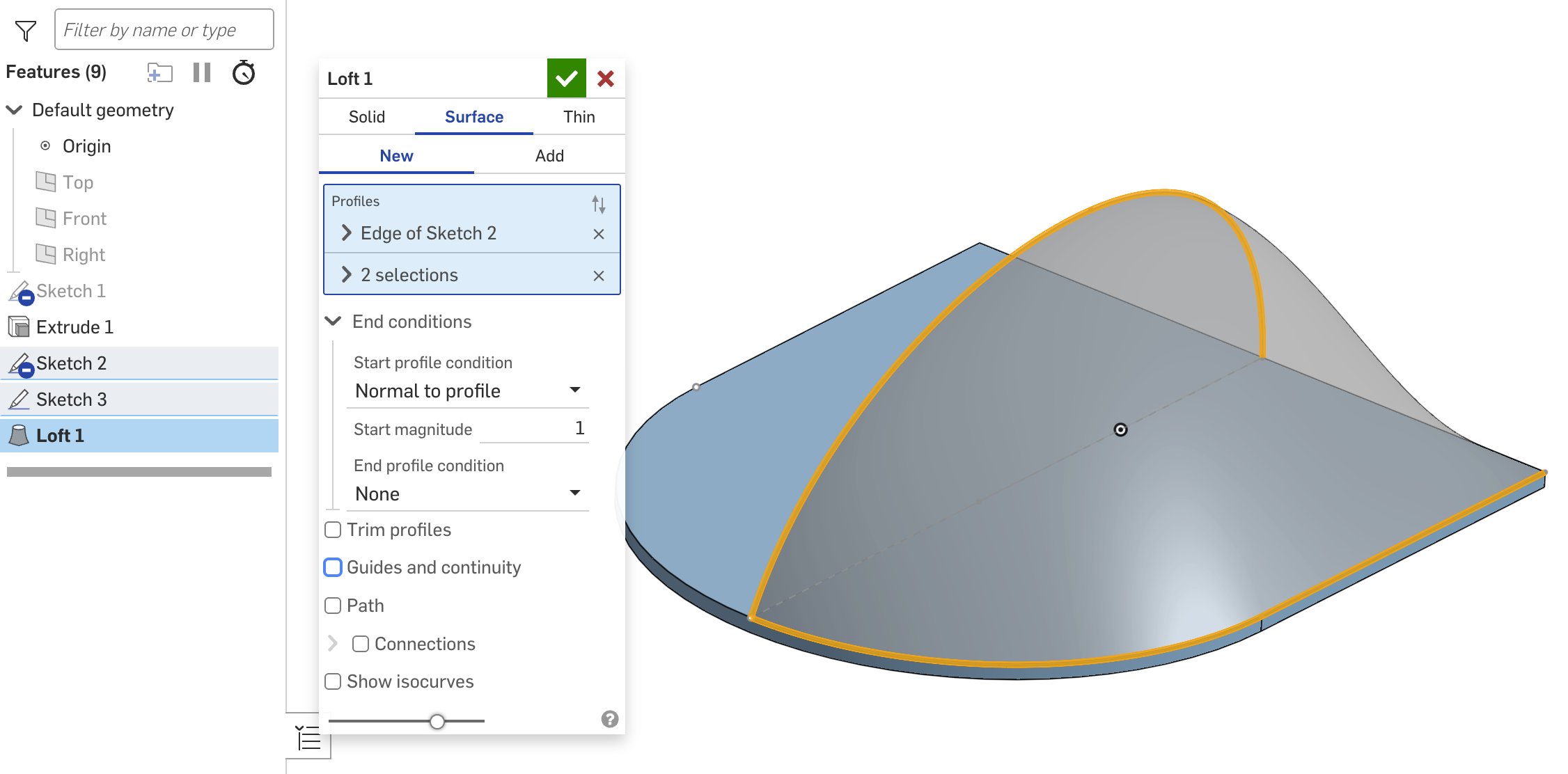

You asked for it: https://learn.onshape.com/catalog?query=surface%20modeling
There is a tutorial named "Understanding curves" which I recommend. That's the one with the helmet, and it covers the solution you're after, when they make the handle.
Agreed. Definitely gonna need to spend some time learning curves and surfaces.
