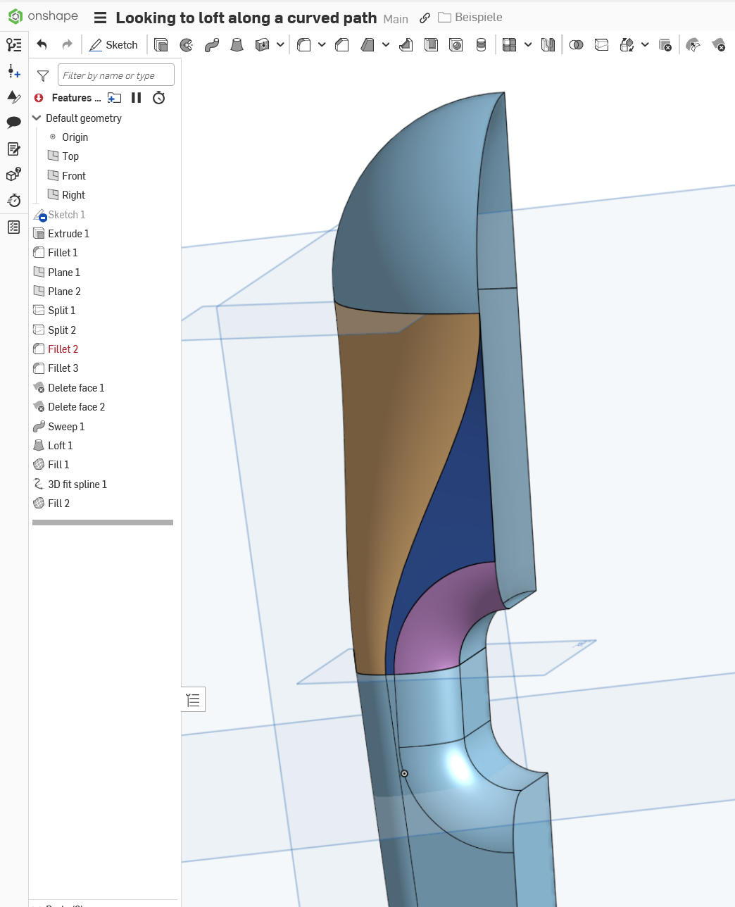

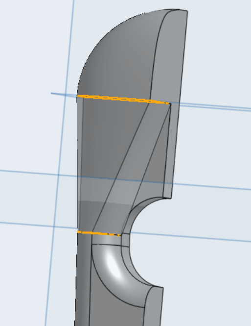

Looking to loft along a curved path
Not sure if it is possible but I am looking to loft and loft around this curved path
  • martin_kopplow
    It gets more complicated the more existing faces are involved. If the radius (fillet) is a feature, I'd suggest applying it after the loft is done. That'll make it much more reliable. If it cannot be removed, I'd suggest making the part that attaches to the fillet first (The pink one below), and only take care of the rest of the loft after that (the brown face below) and then close what remains open (dark blue).
    It would help, if you provided a public link to your sample document, so people here could look at the real thing and propose a spot-on solution.
    A wild guess:
    https://cad.onshape.com/documents/83effe9f8e4185564abdb282/w/9fbbeed1c1d2ab6653aa9f54/e/b627555358e66989e3ff3ae4?renderMode=0&uiState=68d661378dad66d804f30975
    Anyway, the shape you have there appears not to be very well suited for this kind of editing. A bit of remodeling might be required in order to get a nice shape.
