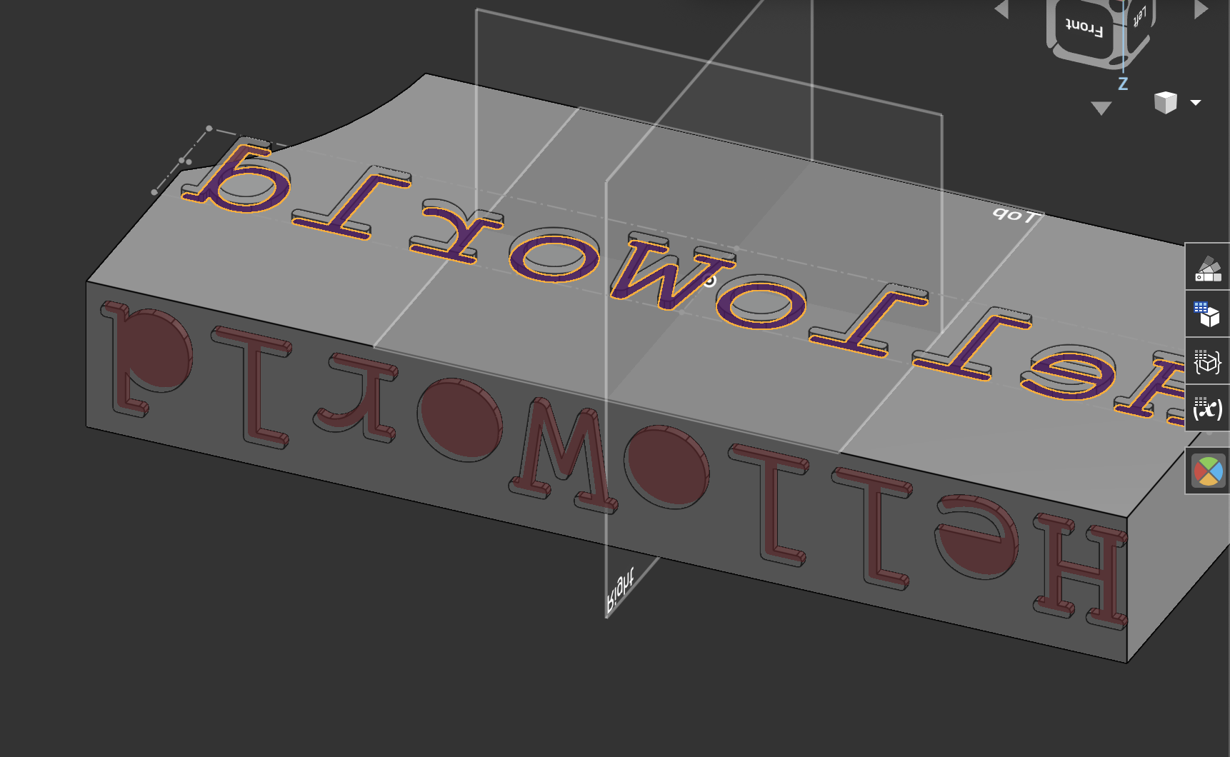

opTransform with sketch text will fill holes.
This image shows what happens when extruding (with opExtrude) after a opTransform (in red) versus directly (in blue) .
Here's a simple code to reproduce the error :
const targetPlane is Plane = evPlane(context, { "face" : definition.target });
const planemap is Transform = transform(sketchPlane, targetPlane);
opTransform(context, id + "transform1", { "bodies" : qOwnerBody(definition.faces), "transform" : planemap });
const normal = evPlane(context, { "face" : definition.faces }).normal;
opExtrude(context, id + "extrude1", { "entities" : definition.faces, "direction" : direction, "endBound" : BoundingType.BLIND, "endDepth" : 1*inch, });
version used is 2770;

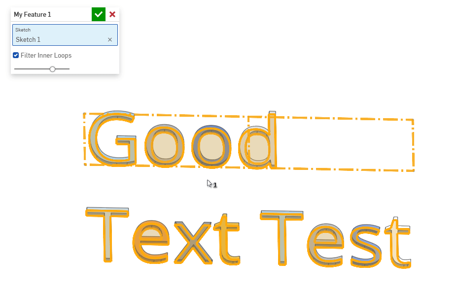

    The issue is how you are querying for the faces to extrude.
    When you reference a sketch region, you can filter in the inner loops.
    https://cad.onshape.com/FsDoc/library.html#qSketchRegion-Id-boolean
    qSketchRegion(sketchid, true);
