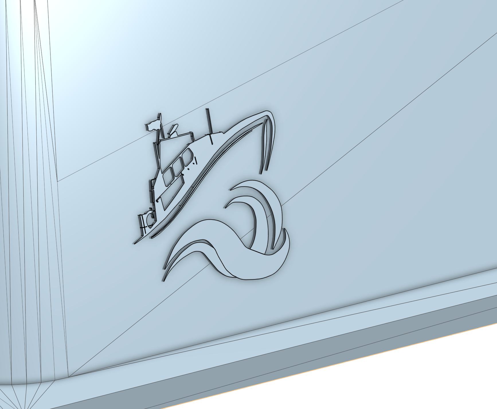

I'm making the enclosure for the my Flashforge and want to customise it with a logo. I have managed to trace an image and I can even get it to extrude but as the face I want to put it on is angled I am having no success. Have tried creating an offset face and using split but with no avail.
Would anyone have two minutes to cast an eye over it and give me idea how to complete this action?

    There are some issues with your approach, but I think you can get to something workable anyway. I created a plane and moved your image trace there. It isn't working to boolean the parts together I think because the trace is fairly wonky, BUT if you don't mind the logo protruding instead of cutting away, this doesn't really matter as you can export and print as a single stl even if they're not merged here. You could possibly even subtract one part from the other in your slicer after the fact and it might work since it's doing very different math than Onshape needs to.

    I had a feeling it might be a little complicated as a logo but could fine nothing more simple so it's well worth a print. I understand that I should be able to add text directly in the slicer.
    I just couldn't work out how to put the on an angled surface. Tried for hours just putting a simple wave onto the surface but cannot get it to match the angle of the surface. If you could point me in the right direction for future that would be fantastic. Couldn't even find a YouTube video as didn't know what to search for.

    Create a 3 point plane on that surface and put your sketch on that plane,
