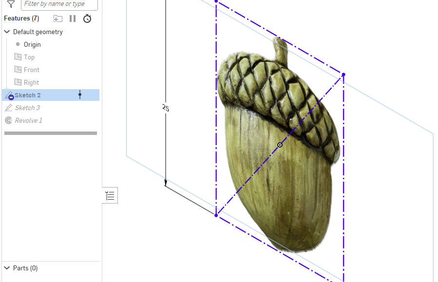

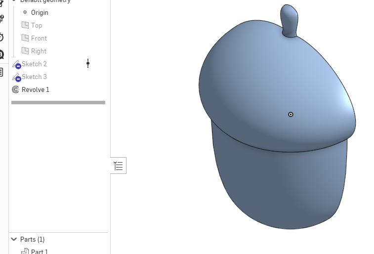

im trying to make this and it should only have a height of 25mm when i revolve it
i tryed a few things but did find the command yet :(
i linkede it here

Scaling the image will start you off right before trace. Height of image window is 25mm. Minimum points on splines to get the shape needed is preferred for smoother objects that are simpler to edit. More points can be added to splines if needed.
