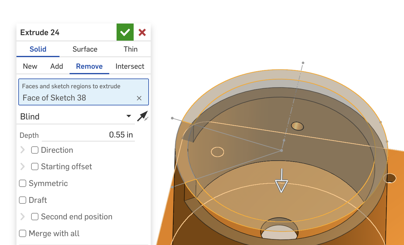

    Sketch 38 is not solved so doesn't produce valid faces for an extrude cut. It's a simple sketch.
    Open the sketch, delete all the line segments.
    Click the inner edge of the cylinder. Click 'u' to use it. This creates a projected sketch entity.
    Click the outer edge. Click 'u'.
    Click the construction lines. Click 'u'.
    With the constructed lines selected, click 'q' or the construction line sketch tool. This will convert the construction lines in to solid lines. The sketch should then solve.
    In Extrude 24, select the sketch area that you want to use as your cutting tool. Because the sketch is solved and the resulting faces are valid, it can cut away the area you want to remove.

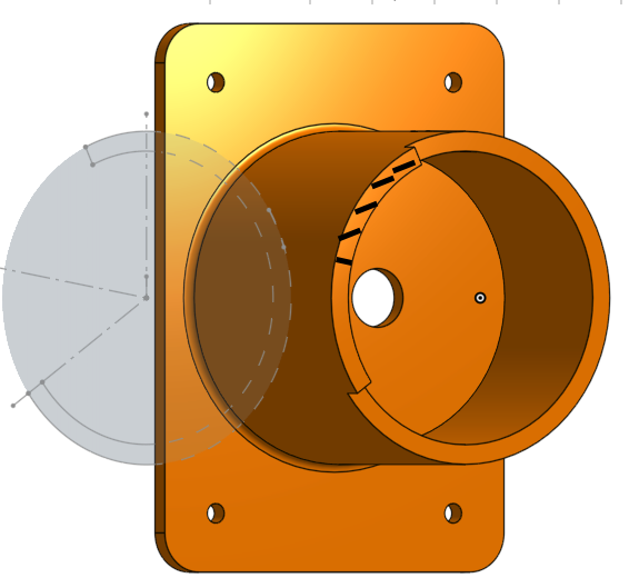

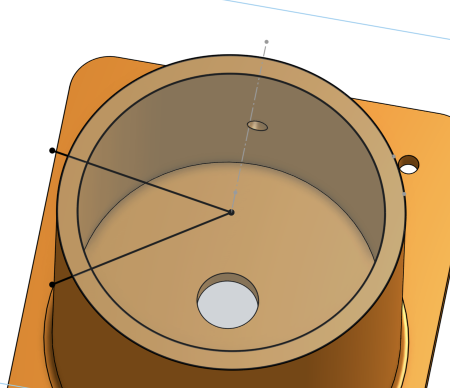

    The sketch is somehow used to associate with the extrusion later on, I thought all i would have to do is alter the sketch angles and the extrusion would update.
    See image below on the back of PART4 i am trying to move the angle around on the extrusion to make the jutting out tooth smaller.
    In the second picture you can see the material i wish to remove.
    Any help greatly appreciated.

  • jnewthjnewth Member, OS Professional Posts: 105 PRO

  • david_brothers784david_brothers784 Member Posts: 5
    Thank you so much for your help jnewth - much appreciated ;-)
