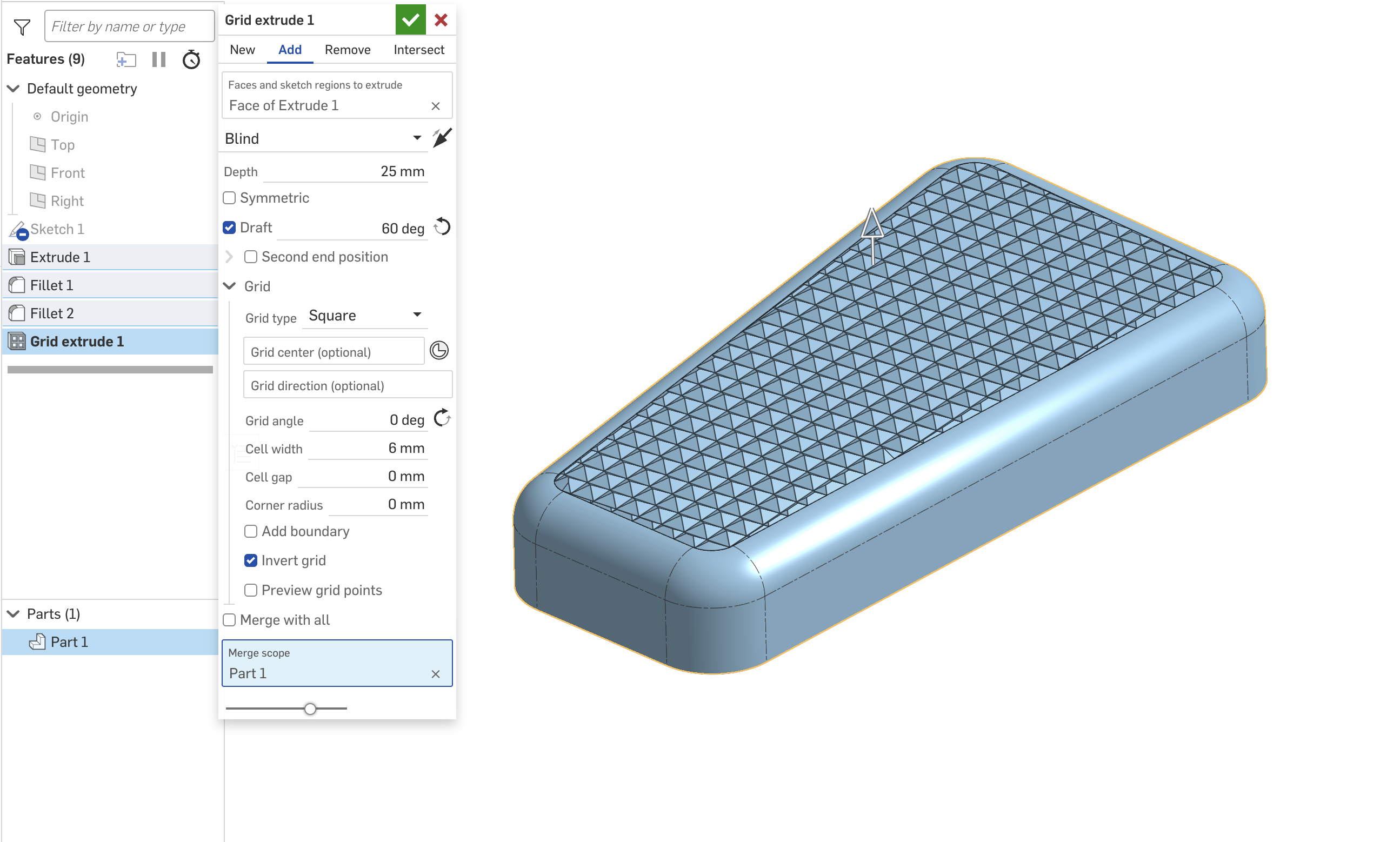

    if it's on a flat surface Grid Extrude is a good option.

    Thanks Evan. Unfortunately not flat.

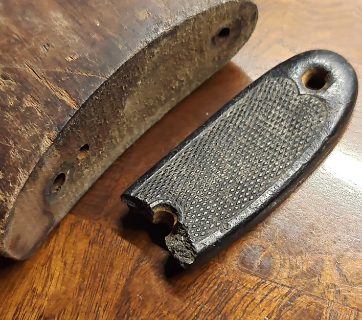

    Good point guess that would help. This is the original piece. the checkering is filled with dirt in this case but its a diamond pattern.

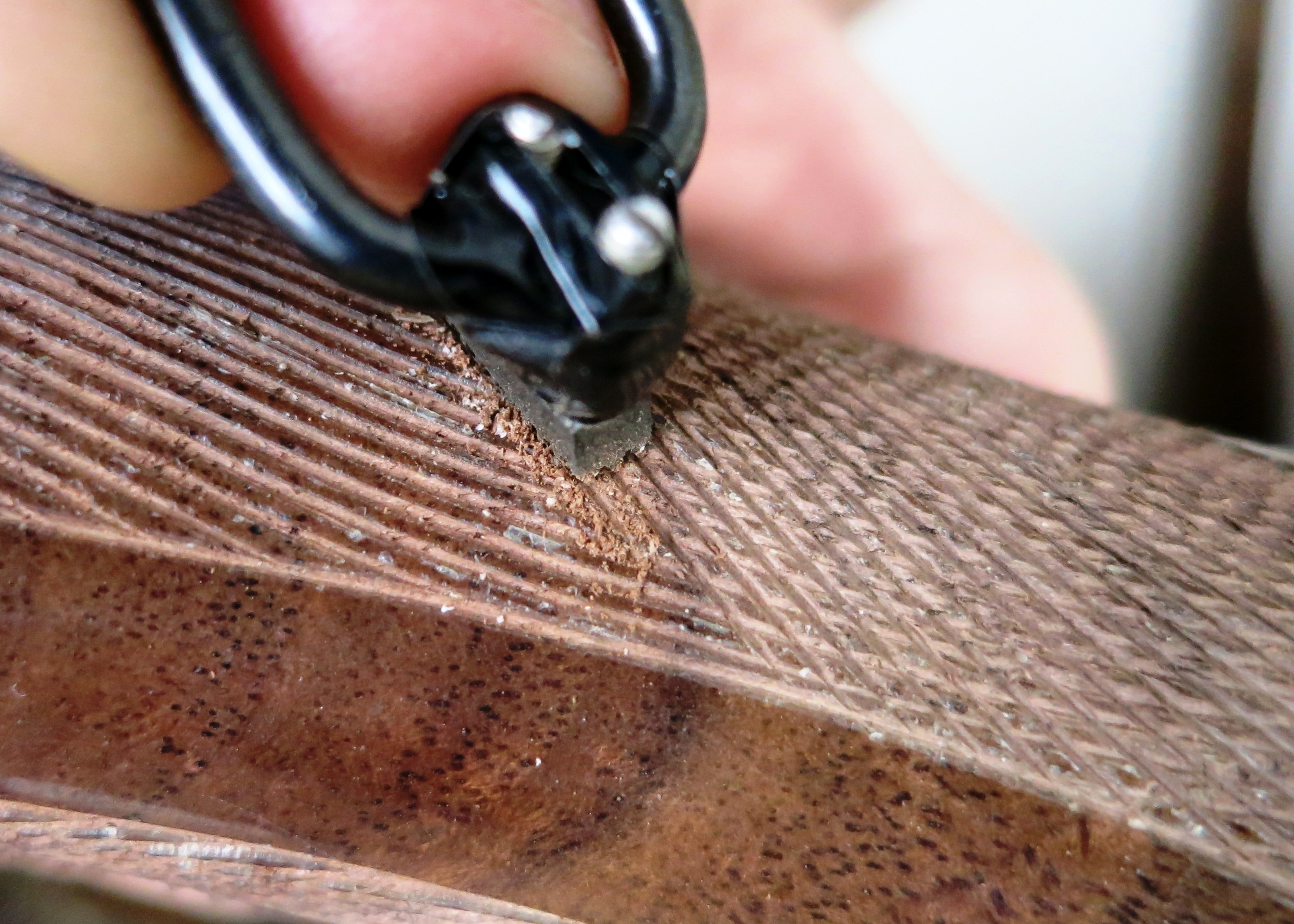

    Here's a close up of how its done in real life.

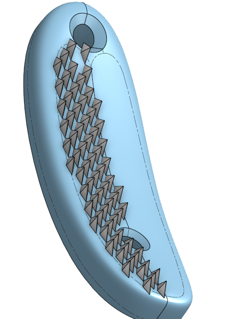

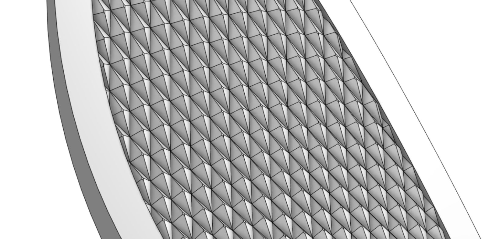

    You can do that with texture, or with a feature pattern:
    Here is how you can do it with the Texture feature, not quite a knurl but fine for printing:
    https://cad.onshape.com/documents/432c706e5b5adf3c760d1adf/w/b225de7623a68e9a21148e57/e/bae2d12486ac…
    And here is a more precise knurl approach using a feature pattern:
    https://cad.onshape.com/documents/432c706e5b5adf3c760d1adf/w/b225de7623a68e9a21148e57/e/7b49f10533f4…
    • Note that feature patterns are currently a bit broken with sketches. So if it doesn't work, you will have to use a work around until the pattern accepts your tree.
    • This was tricky as it required a sketch to be projected to the compound surface. Using a mate connector and the pierce constraint seems to work well. Implicit mate connectors do not work well in feature patterns at the moment though, so make sure it's a normal mate connector and that nothing in the sketch is constrained in a permanent non moving way if that makes sence.
  • MDesign
    Woah. What in the tarnation? I need to study up on how you used that as a linear feature pattern. The brain is not braining on that one yet. Thanks for whipping that up. I'll see if I can make it work on my part.
