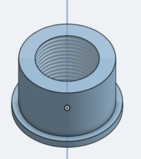

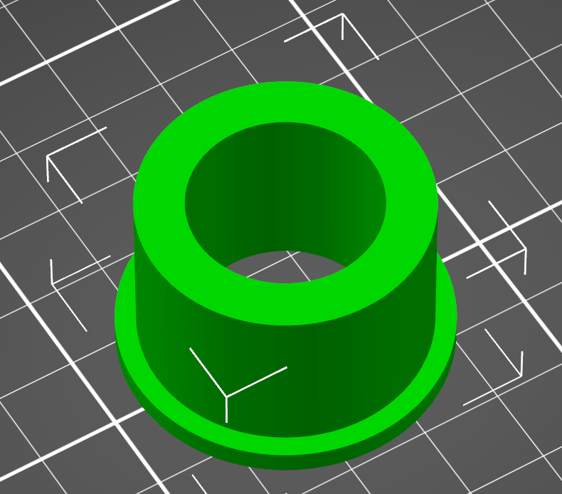

I've created a simple model, with a hole tapped with NPT 3/4" - 14 TPI. I need this 3D printed, so exported in to 3mf (Prusa slicer). In the Prusa slicer the thread is not modelled.
Questions:
1: what am I doing wrong to get the thread exported?
2: why is the thread not tapered in the design in onshape (bottom diameter is samen as top diameter!).
Many thanks for your feedback.
Marc

    You've used a cosmetic thread feature which only applies a decal to the face of the object. The custom features I'm aware of that do modeled threads don't support NPT thread geometry so what I do instead is download a McMaster Carr part that has the thread geometry I want to borrow, cut away anything that isn't relevant on that model and derive it into my part studio to use with a boolean feature.

    In a more general answer to question 2:
    By default threads are not modeled. On large assemblies or parts with many threads they slow down the software. Traditionally 3D models are used to create eng drawings to be used for 'subtractive' manufacture.
    On eng drawings threads are represented by thin parralel lines either side of the thread for a side view, or a broken circle for an end view. Threads are not drawn, because eng drawings used to be done by hand and drawing threads is effort. Therefore threads don't need to be modeled, just specified.
    In order to print a tapered thread you would have to model the taper, and the thread.
