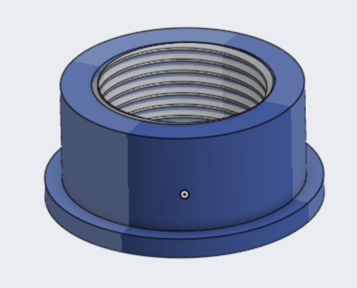

I've created a simple model, with a hole tapped with NPT 3/4" - 14 TPI. I need this 3D printed, so exported in to 3mf (Prusa slicer). In the Prusa slicer the thread is not modelled.
Questions:
1: what am I doing wrong to get the thread exported?
2: why is the thread not tapered in the design in onshape (bottom diameter is samen as top diameter!).
Many thanks for your feedback.
Marc

    Thanks for the hint, I got it from Mc Master-Carr, and unbundled it until I had the thread surface. Now I'm stuck in using this thread surface into mu model! Any idea? Apparently solids and surfaces cannot be merged. :(
  • marc_van_campmarc_van_camp Member Posts: 6
    I didn't arrive in getting the thread integrated in my model (found no way in merging the thread surface into the solid part!)

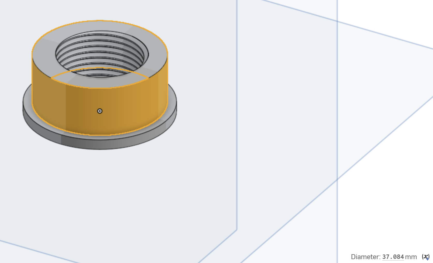

    I started from a McMaster-Carr part (4464K355_304) and used only the bottom part of it. Disassembled it (removing the surfaces) until inly the thread was over. Build the solid part around it (sketch + extrude) (see picture in my previous post).
    So finally I used the part as such and used split and transform to get the bottom part on the positive side of the top pane. and merged it with a solid part for the overhang. But resulting in something which does not have the exact measures as it should be (diameters + 2 mm).
    If anyone knows the tricks to get what I exactly need, Please feel free to help.

    Many thanks Derek! Very clever idea this studio approach! I'm a newbie in modelling, so such kind of information means the world to me.
    Tryng to use what you have done, fails because I have not the proper permissions (view only). I suppose that you have used your cutting tool (the NPT thread) to create the new model of the insert. I need to be able to export it to 3mf to 3D print it. Another question, for the NPT thread where did you put the largest diameter, on the top of the insert or on the bottom. The correct position is the bottom.
