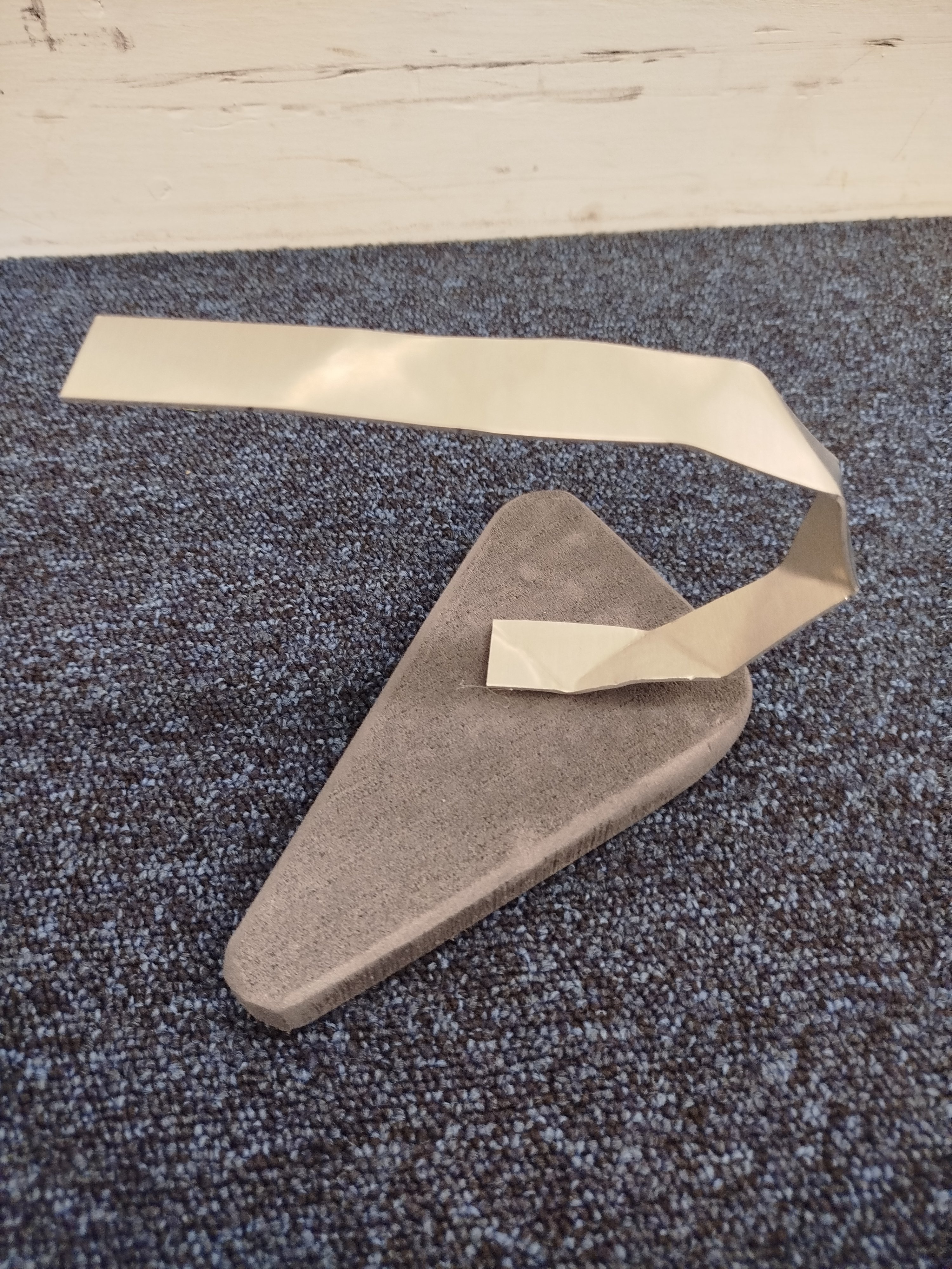

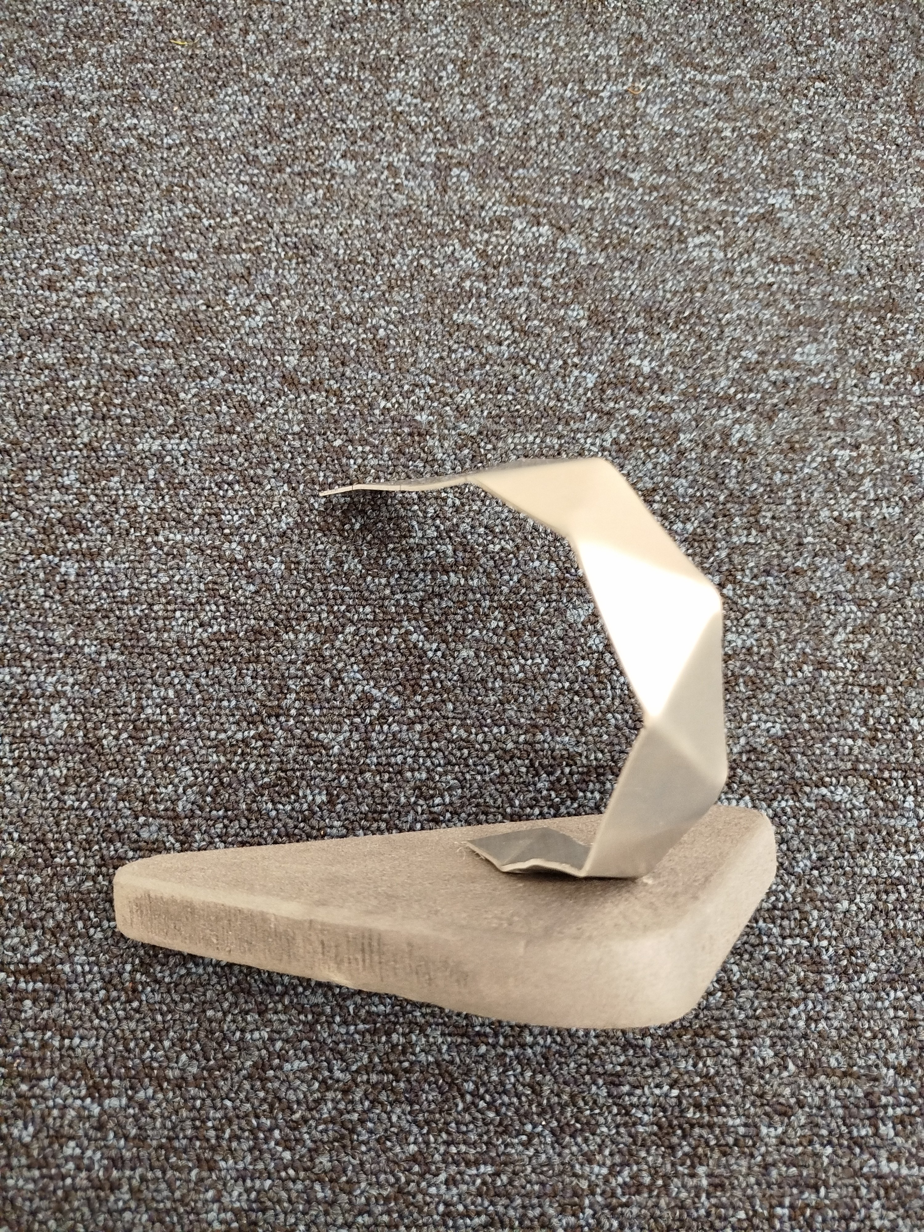

I want to make the 3D model of this lamp model (attached) in onshape but I'm not sure how I can design the faceted structure of the curved metal structure. Can anyone help?
Thanks
  • GWS50GWS50 Member Posts: 498 PRO
    edited October 2025
    As with most modelling problems there is more than one way.
    Here are 2 approaches…..Studio 1 is using the Bend Line option and studio 2 is using the Sheet Metal Convert option
    https://cad.onshape.com/documents/e7d9c98b7c3dda4ea177ac92/w/5335749d5eff6f5bfb38ca27/e/0b76c26b6f542db101ef7d9e
