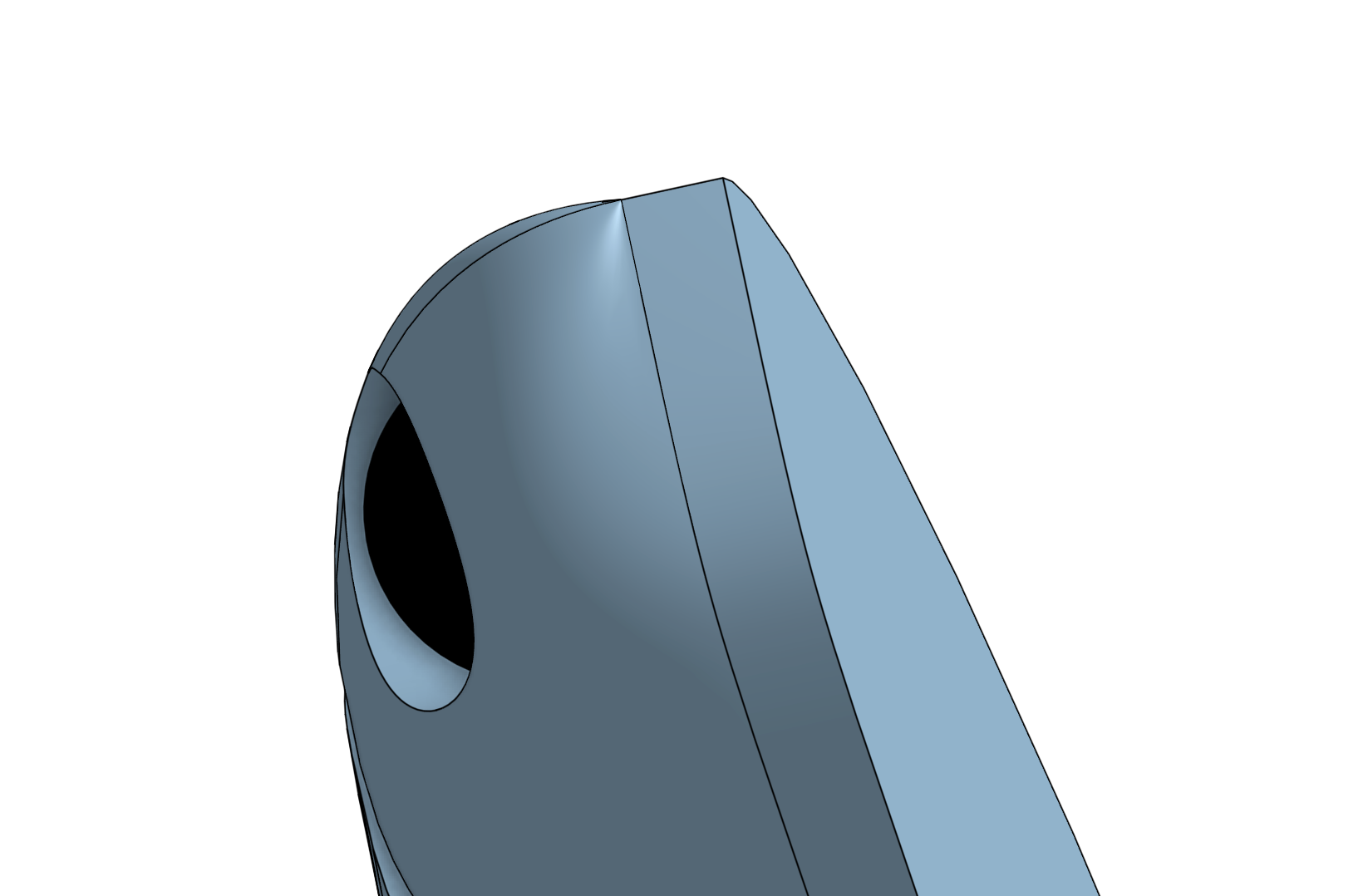

I'm currently designing a fishing lure using lofts, which is causing some undesirable bulging at the nose. How could I fix this without changing the profile of the bait?
I have linked the document below. Thanks!
Screenshot 2025-10-18 at 11.59.17 AM.png There was an error displaying this embed.

    I tried a slightly different approach and used surface lofting and then enclose to convert to solid
    https://cad.onshape.com/documents/8a604851ff5a481b60905997/w/07eeed28b8c799a19d729d68/e/22ea080924bb9ef8f834cc01
    I hope this helps

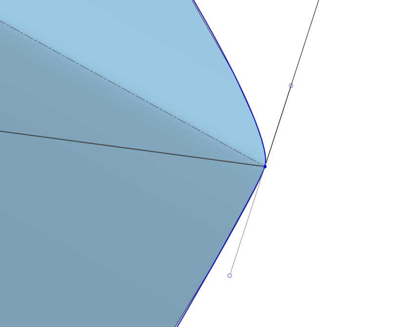

    Even though you think you want the nose at a point. It will result better if you have a little curve in your sketches at the points. This is zoomed way in. these magnitude lines on your spline are just .01 mm long with one set to vertical and the other coincident

    Really appreciate the help. That worked really well but also causes some other wierd contours along the back… good start to wrok on though
