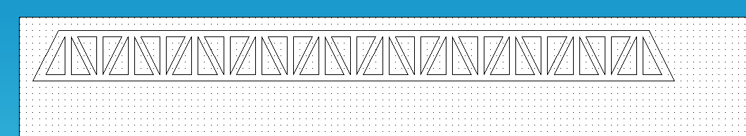

I have managed to import a drawing from 2D design (dxf or JPEG) but can't then extrude it (or work on it).
If this can't be done, how do I draw the image below please on Onshape (I have tried now for an hour and give up)/ Any help would be very much appreciated.

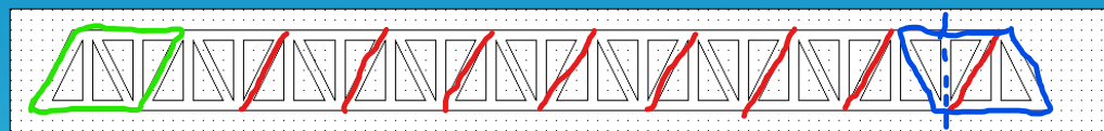

    There are many ways to do what you want, Here's one
    Start with a sketch & Import your DXF there.
    Create the green extruded outline area. (GREEN)
    Linear Pattern it. (RED)
    Mirror the last piece to create the end (BLUE)
    Boolean it all together.
    That's just one way. There are a bazillion others.
