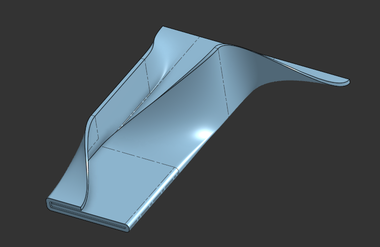

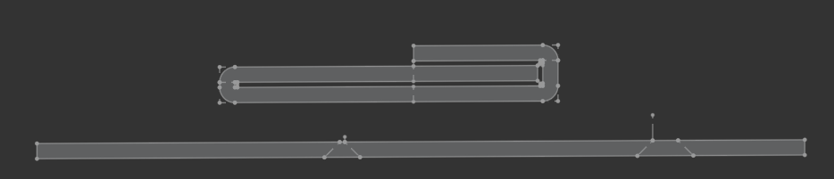

I'm trying to create a tool to fold a sheet of paper/fabric on top of itself. The idea is to have flat pipe transit into folder form:
I thought a simple loft will do the trick, but it turned out to be more complicated than that - the loft failed.
Then I tried adding intermediate stages to guide the loft, but it still failed.
Next I've tried loft each stage separately, it worked, but boy it looks bad:
So, I hope someone could give me some tips how to achieve this
Thank you.
Here is my attempt so far:
https://cad.onshape.com/documents/965e02869a41c2cdf8e8c938/v/38854d19f3e78441cc469270/e/2db47233236336a26045307a?renderMode=0&tangentEdgeStyle=1&uiState=68f7a7bd6494637069a82401
  • MichaelPascoe
    MichaelPascoe Member Posts: 2,938 PRO
    Would this be a bi-directional fold? Kind of like a map? If so, then you could just take your sketch and sweep it along another fold path.
