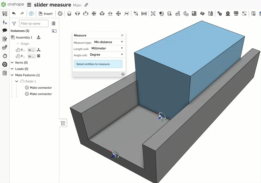

I have a slider mate and would like to display within an assembly (somewhere) the Z variable value as a text output. That is display the Z position in plain text. Is this ossible, and if so how please?

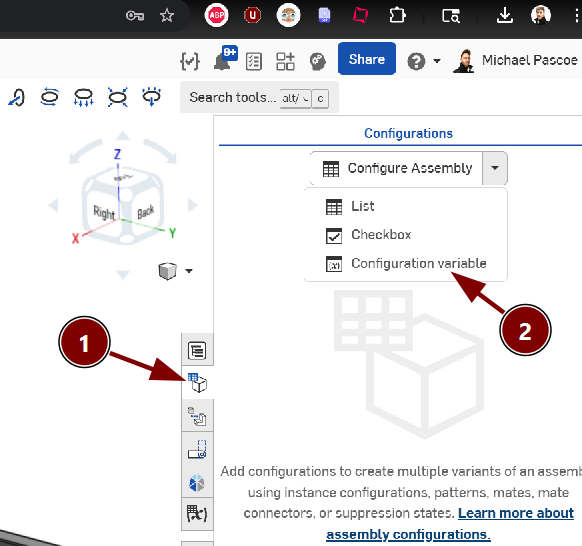

  • MichaelPascoe
    edited October 2025
    It is currently not possible to measure values within the assembly and then use them in configurations or configuration variables.
    Here is an improvement request you can vote on which would allow this functionality. Assembly Driven Variables - Improvement Request
    You can do this in a part studio, but then you wont have the slider mate.
    One alternative, which would not be as interactive but would work, is to have a configuration variable in the assembly, and use that to drive the slider position and the text.

  • GregBrown
    I'm not clear from your question whether you needed the output of the measurement as a variable, or if you justt wanted to see the current value on screen as text…
    If it is the latter, then the measure tool will update dynamically. Just select the two mate connectors that are part of the slider mate, and activate the measure tool.
