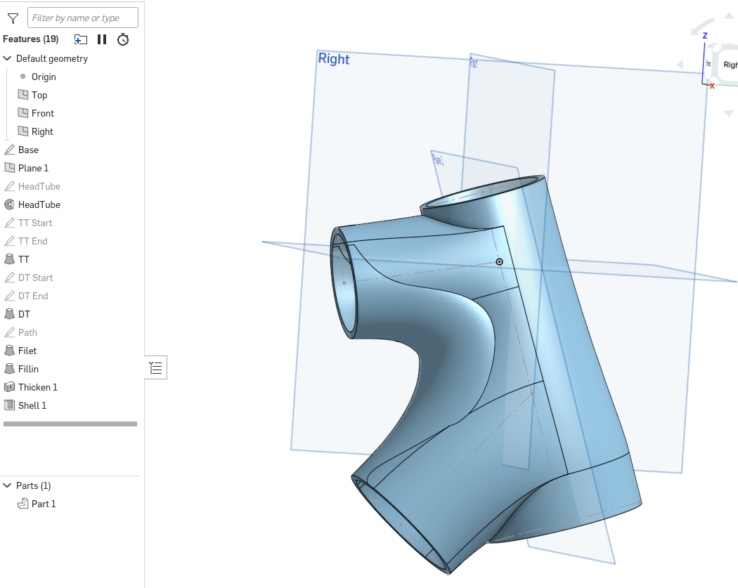

Hi all,
I'm in the design of a bicycle frame with 3d printed lugs and carbon tubes. But I'm still struggeling with a clean organic shape for the lugs. As an example, I made a simplified lug. Can you help me in how to do it the "clever" way in OnShape? As you see on the picture, I do not get a smooth transition between the loft of the tubes and the "filet" between these lofts.
https://cad.onshape.com/documents/3962d9bf5086bf7cc2562aaa
  • rick_randallrick_randall Member Posts: 411 ✭✭✭
    marcel_graber - You might try working with the variable fillet option inside the fillet command - there is a bit of a learning curve involved. I've found that getting a perfectly flowing organic shape can be quite challenging.

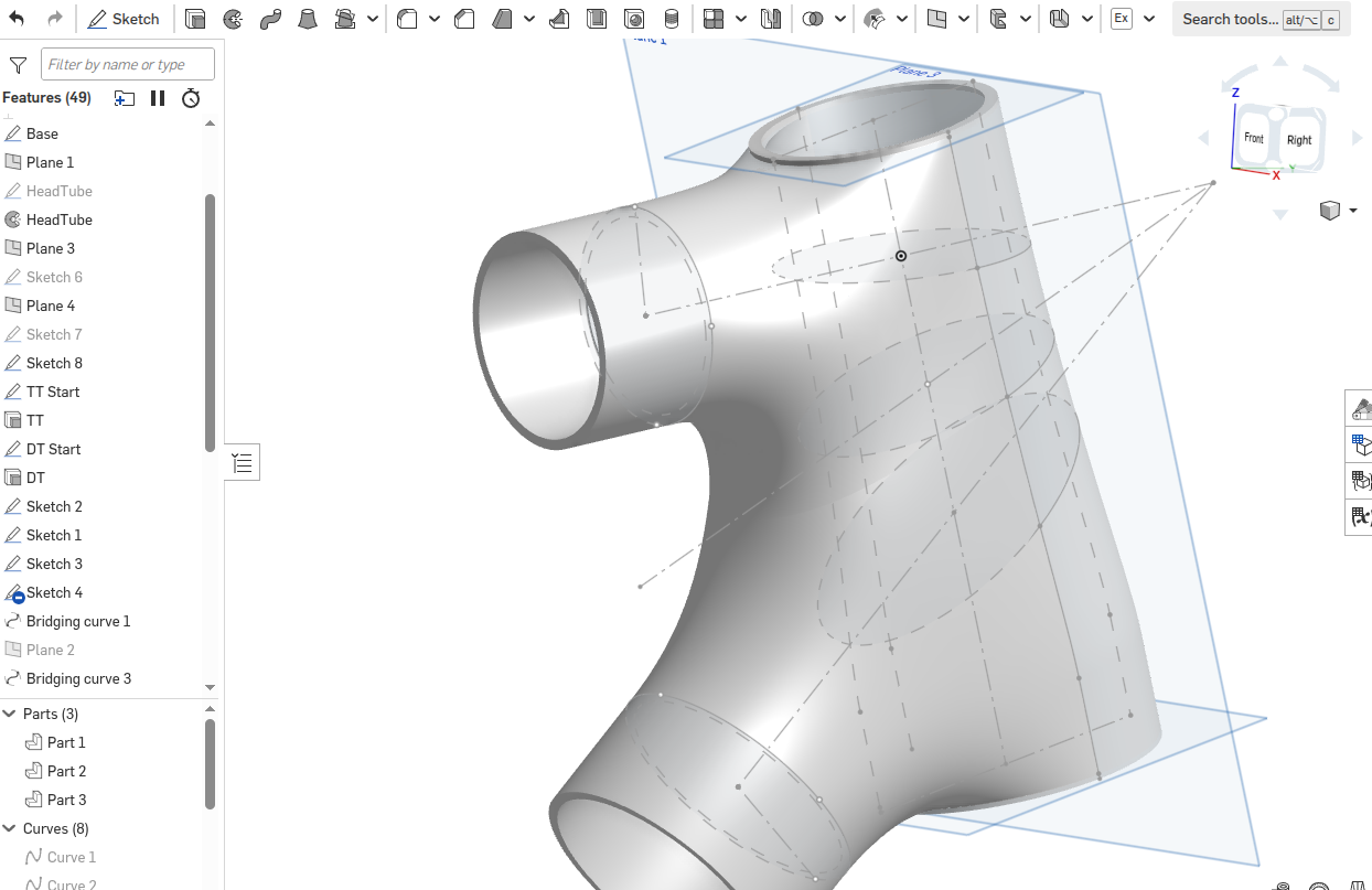

  • marcel_grabermarcel_graber Member Posts: 7
    Thanks @rick_randall
    I tried the whole day… the problem with the fillet is, that it brakes, when I change the base geometry (which happens often, because of the different frame sizes) I tried another approach with bridging-curves and fills. Looks better now, but still not perfect.
  • S1monS1mon Member Posts: 3,750 PRO
    These kinds of joints are extremely challenging with any NURBS based modeling tool. NURBS are by definition 4 sided surfaces, but there's no simple way to break up this transition without 5 or 6 sided surfaces. Even then, those surfaces don't necessarily have a natural order of which one(s) should be first and influence the following ones (beyond perhaps the tubes being fundamental). Even with something like XNURBS, which is like Parasolid's fill surface on steroids, it's going to be a lot of very careful tweaking to get anything decent.
  • Matt_ShieldsMatt_Shields Member, Onshape Employees Posts: 841 PRO
    I know Onshape's surface modeling tools are up to the task. I hope one of the community surfacing experts will chime in with a proper solution, but here are a couple of tips in the meantime:
    • Start with surfaces, rather than solids
    • Take advantage of symmetry and start with half of the model
  • MDesignMDesign Member Posts: 1,259 PRO
    edited October 26
    Is this closer to what your looking for? Hard to visualize what you have in mind. Getting it clean definitely requires some understanding on how onshape thinks.
    Patchwork quilt method. The top and bottom blends are just fillets but could be done the same way as the middle as follows. The patch in the middle was made by splitting the surfaces and deleting the surfaces I didn't want then a quick single curve sketch to control/connect the inner curvature and fill surface feature with a bunch of tangent edges. thicken and mirror.
  • EvanReeseEvanReese Member, Mentor Posts: 2,681 PRO
    This is a classic surfacing challenge. The idea is to use patches instead of trying to do huge blends all at once. Here's an approach. The result isn't yet perfect, but I'm out of time to mess with it. https://cad.onshape.com/documents/18539836b527ad1961df5147/w/d5397f64f47e0cec44f42c19/e/9f6d742b6320cf4452bf19ce
