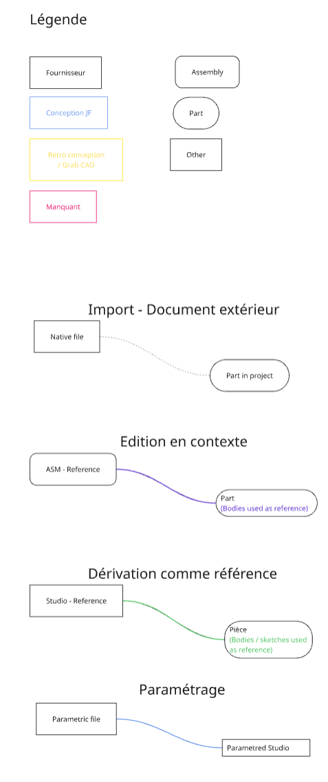

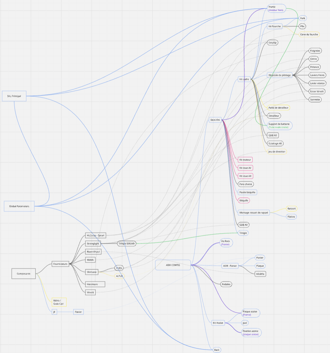

Hi,
I want to do a mind map of my CAD as it's getting pretty complex. I want to include the studios, the parts and assemblies and where they came from : imported or created in onshape, from the current document or anotehr one, and all the links between parts: is it created from a context (which one), does it use derived geometries (from where), is it using a variable table, … You get the idea.
Onshape files can be structured from an assembly and it's pretty good but i'm lacking informations (many the links).
So here is my question : can I access (and export) those CAD informations to make a map of all the links of my project ?
(Here is the current mind map I'm using, I want to upgrade to a dynamic and auto-filling mind map. Excuse the French in the screenshots :)
I'm open to any idea, exporting and doing it with a Data Base, with a linked app or whatever.
Tanks !

    I mainly need it for collaboration purposes. I am an internee and i did the migration of the main product of the company i work for from Fusion to Onshape. I tried to make it a robust product with a top-down conception. So a mind map would be great for the people to know what i did and what's possible to do without making the conception weaker. A map is a cool visual tool, in Cad if a part has two different inputs our if there are too many layers of input, it begins to be tricky. With a map, it can be detected and avoided.
    Basically i'm trying to get people to understand my work and not destroy it as soon as my internsheep ends :)
