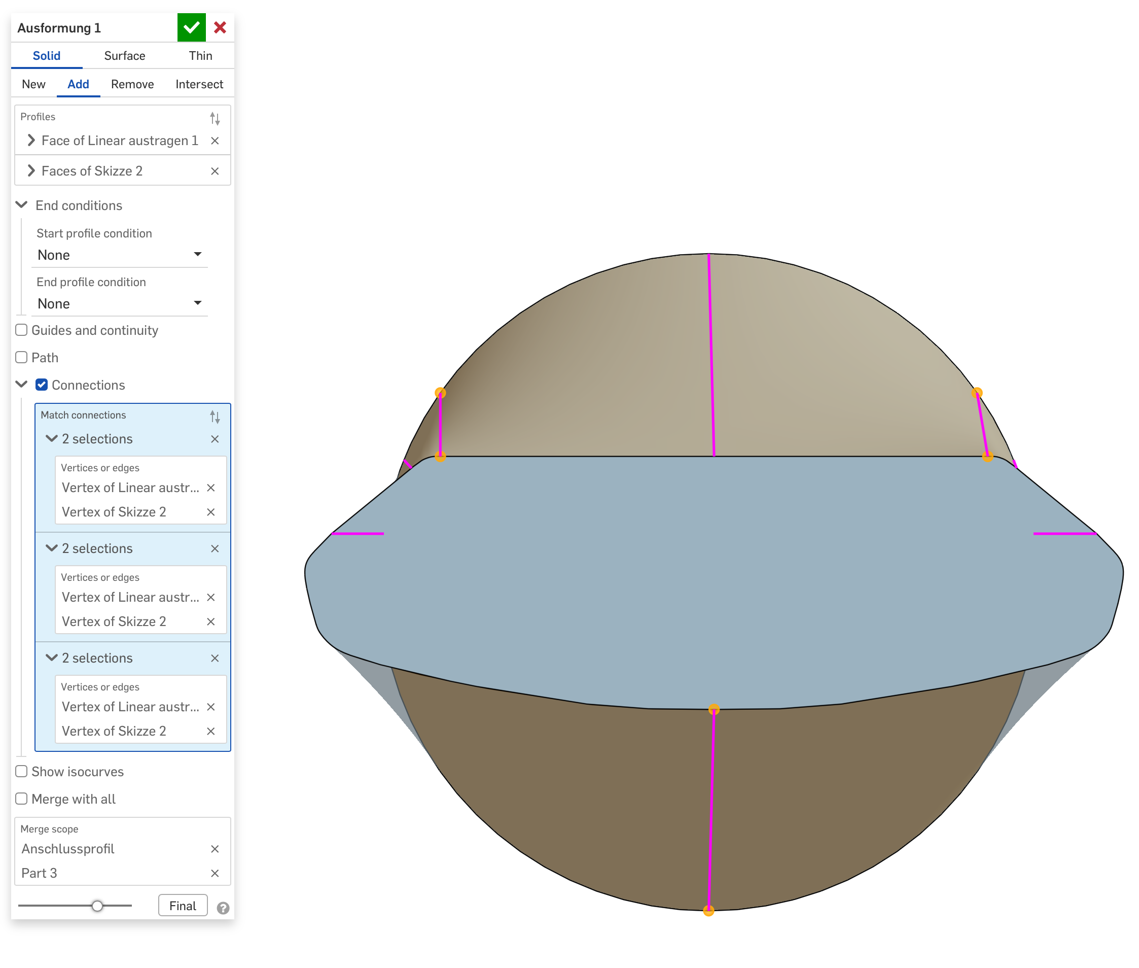

Hello,
I created a sketch which I made symmetrical by mirroring it.
Now, when I try to create a solid from this sketch onto a circle in another plane using extrusion, the result is not symmetrical. What am I doing wrong?
You can see it at https://cad.onshape.com/documents/89d3c418b5035d75a3b5cf39/w/9118c6233d0234ea5cb2ed3a/e/f32b70af73eec819305e9a33
Your sketch 1 is overly complex in terms of how many points you have on the curves. I didn't clean this up.
The loft will be much better behaved if you use connections. I changed the sketch for the circle to have split points and then connected them to some of the points from sketch 1.
