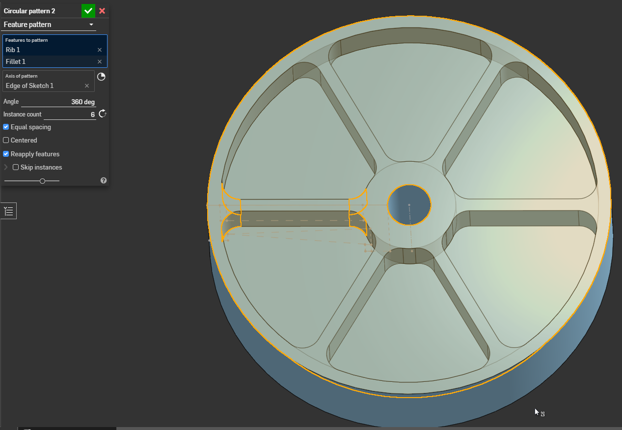

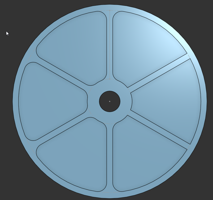

If I circular pattern a rib and some fillets as features the fillets are missing in some instances. What I am I doing wrong?
Please see https://cad.onshape.com/documents/8532e62ea13b01320aca2786/w/7680fd3d6f08a781d9e4f10e/e/6bd21bf22e019531706d08aa

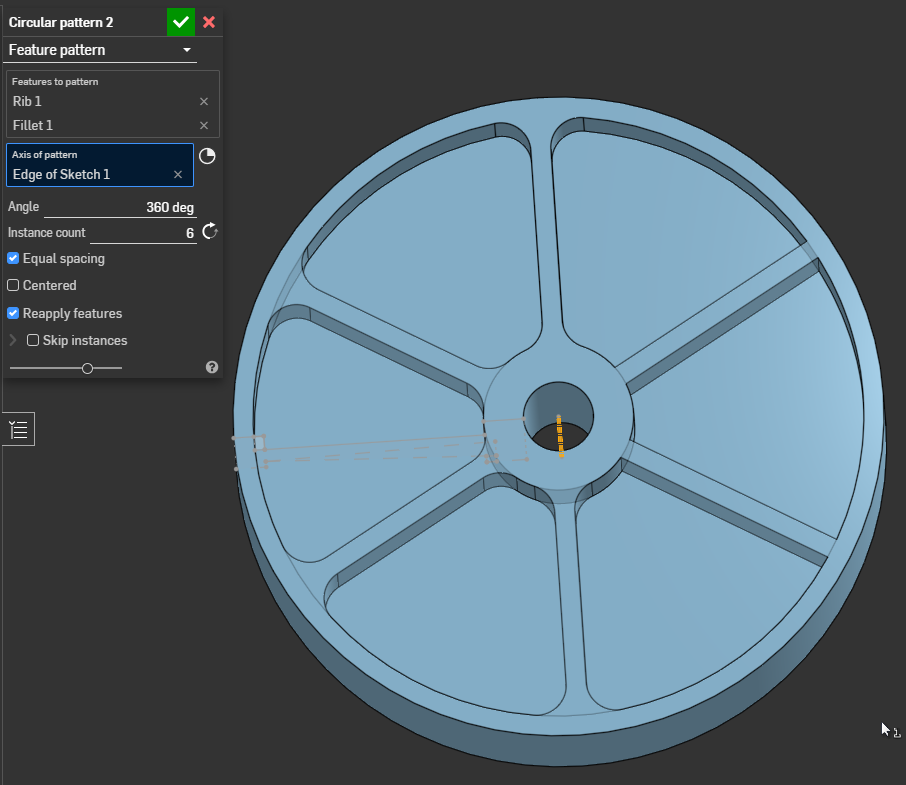

  • bryan_lagrangebryan_lagrange Member, User Group Leader Posts: 976 ✭✭✭✭✭
    Change your axis of pattern to the center hole and it should work.

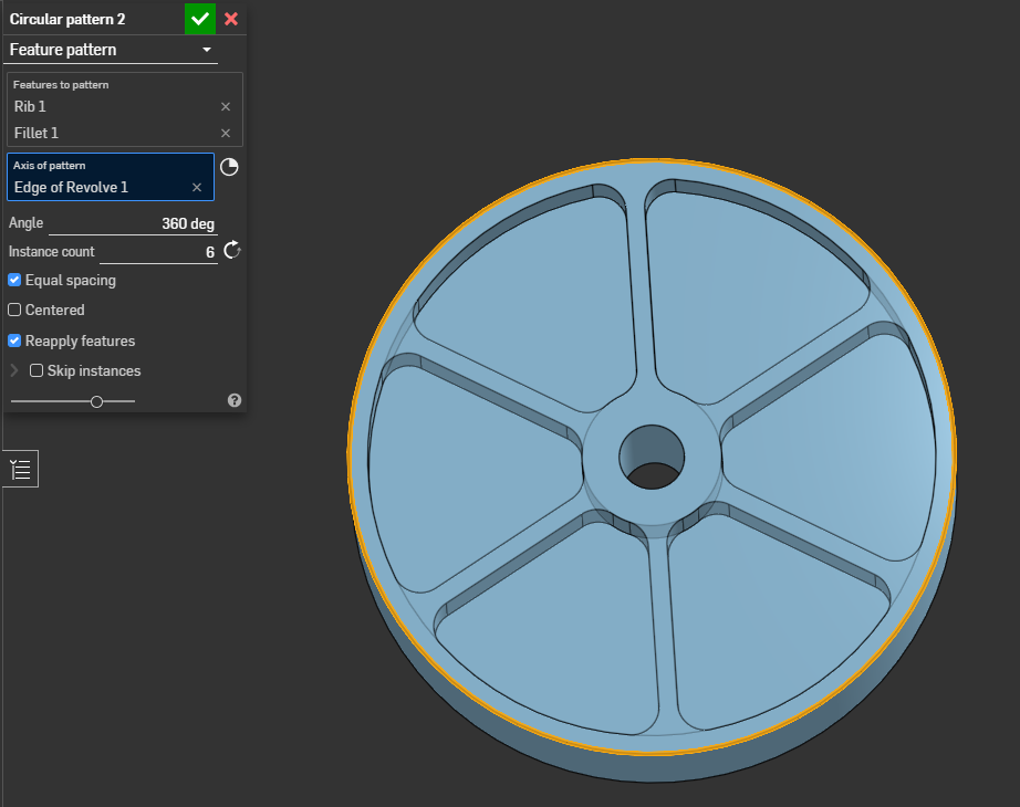

  • roland_koeckelroland_koeckel Member Posts: 11
    @bryan_lagrange Thanks for the hint. It does work if I use the outer edge for the revolve.
    But I have no clue why this does not work with the sketch line that was used for the initial revolve:
    @bryan_lagrange I changed the the rib feature and used a line in the original sketch. Now it also works with the sketch line as axis of pattern. Go figure.
  • S1monS1mon Member Posts: 3,955 PRO
    You could also pattern the ribs and then use a Query variable to select all the vertical corners for a fillet. There are a lot of different ways to solve this.
