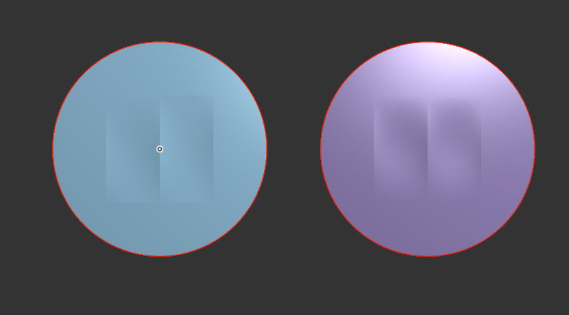

I'm pretty new to FeatureScript, so I don't quite have all of the syntax down yet. I'm trying to play around with opLoft and am having issues setting both ends to match Tangent. Can one of you more knowledgeable folks tell me what I'm doing wrong?
The start tangent works just fine, but the end tangent fails entirely regardless of whether or not the start tangent is turned on.

    Are you able to create the surface with the standard Onshape loft feature? If you can show an example of that working and your feature failing, this might be easier to solve.

    Yeah, I can recreate it with the Onshape loft feature. I just modified the file to include a working version with the regular loft. The purple one is the intended result.

  • ry_gb
    Thanks @GregBrown! That fixes it. I think I understand why now. Looks like I made a typo in the code and had it as "profileIndex": 0, but I also set it to 1 at some point as well. So as I understand it, it's because there are 3 profile curves, right?
