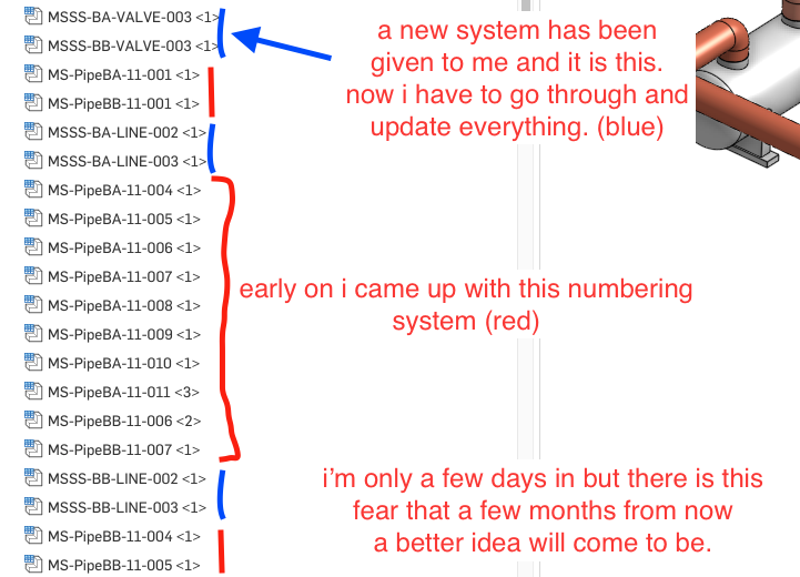

If you really wanted to put AI to good use then it's first task is you would be able to talk to it about how to name everything, add descriptions and work up a part numbering system..
the ability to take a completed project, say 5 years (a design could be sold to another company), and say "let's review the numbering system and come up with a better system, and then fix it" would be revolutionary.
If the "5 years" sound like too much then you could have the AI looking back every few months at the start of the project, making suggestions. This would allow everyone to get on with the work without spending a few days wringing ones hands trying to delvelope the ultimate system.

    @Derek_Van_Allen_BD , ok i get that…but the part numbers on this large project tie into the operation manual, the stream schematics and the actual parts and assemblies. So for a steam line, I need to call it Main-Steam-001 vs 1258625854.
    Then later, after we get into the flow of things, this turns into MS-AA-VALVE-001 to show that the part is Main Steam-Portside turbine Portside of the turbine-Valve-001.
    Hence the request.

    So all of you point to a common failure of smart numbering and that is, one does not know what curveballs are coming in the future, ok granted.
    Part numbers aside, I assume you all have to give everything names? Then you have drawings with drawing numbers which are kind of like part numbers…so there are a lot of "names" to manage as the project grows.
    So, wouldn't this just make the case stronger for using an AI to sort out all the curveballs?

    Take the above image and the name/PN "RHSS-AB-LINE-009".
    When I started a few days ago I wrote it as "RH.AB.Line.009".
    Question, How does one update the names to use "-", make all text caps & other fixes? Another case for AI assist.
    The CAD guy needs to have the freedom to just plow ahead with whatever works for this weeks deadlines, but have the confidence that in 6 months he can go back with AI assistant and reorg the project. This would be a powerful use of AI.

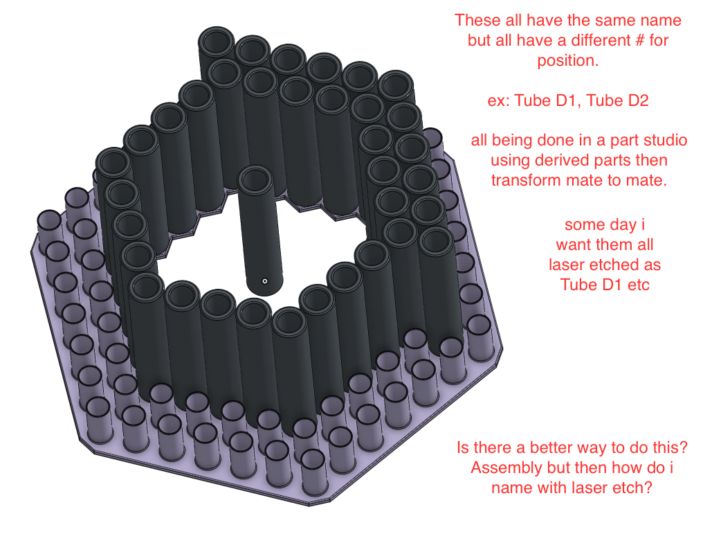

    How would you do this?

    Every tube has a different number despite being the exact same geometry? I can tell you how I'd model it by not using transform but maybe 2 times. But that's not going to help fulfill your numbering desires.
