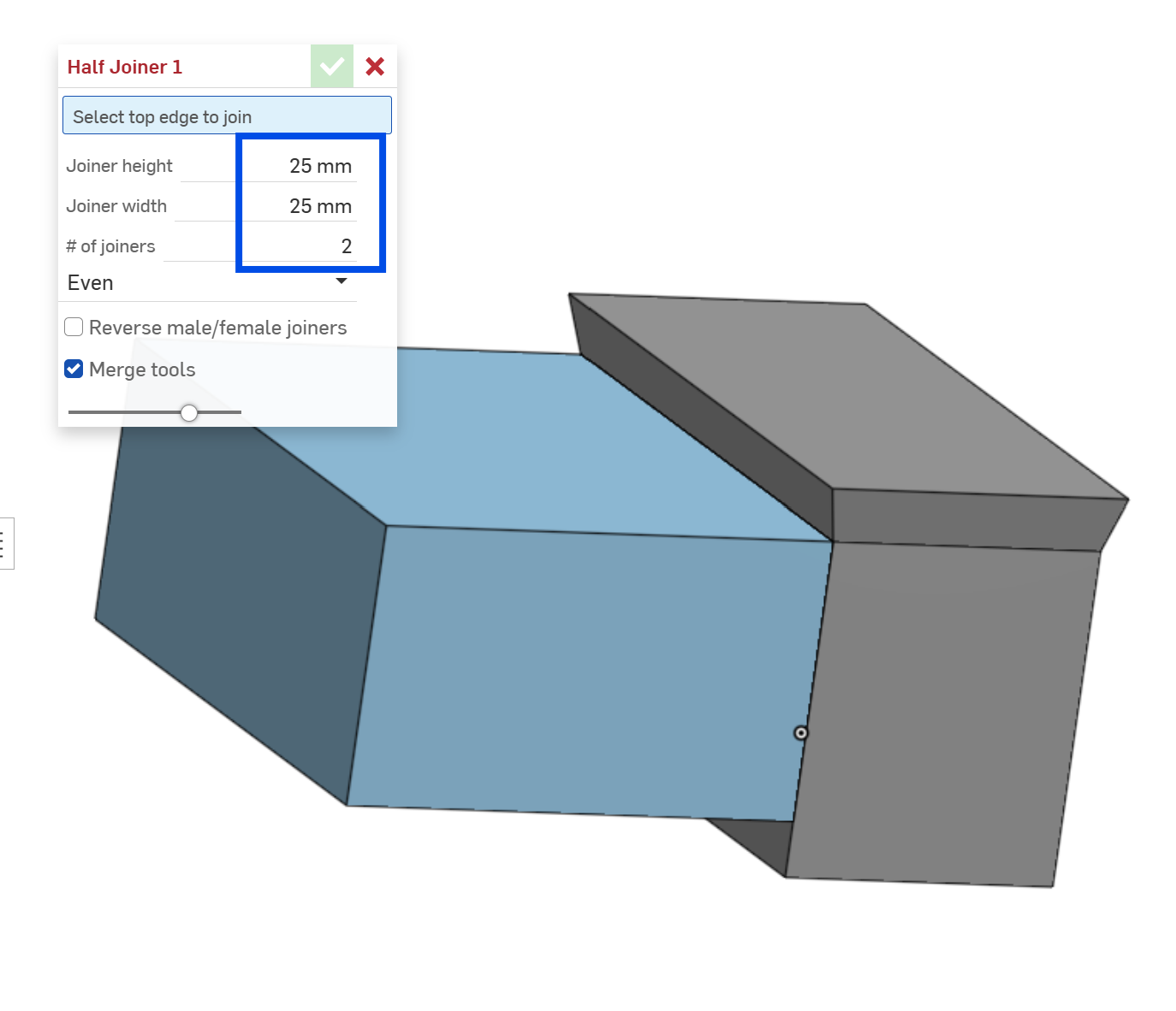

Hi all,
I am close to releasing a feature script to the community, but I am struggling with getting the feature to use the default sizes that I pre-populated. For some reason the sizes keep going to 25mm and the qty keeps going to 2. When the qty doesn't default to 1 it also messes up my attempt to hide a sub-menu about the distribution of the parts.
Any help would be great! Thanks!

    This will get you a parameter with a range of 0-1000 and a default of 60.
    annotation { "Name" : "Wheel Diameter"}
    isLength(definition.diameter, { (millimeter) : [0, 60, 1000] } as LengthBoundSpec);

    Hi Matt, thanks so much for the comment, it worked great! I am not sure why my previous comment didn't go through, but I hope to asked if you might have a similar solution for a simple integer value?
  • jason_ryan337
    jason_ryan337 Member Posts: 91 ✭
    That worked awesome for the two distances!! Thanks!!!
    Any chance you know how to do something similar with a quantity?
        // Quantity
        annotation { "Name" : "# of joiners", "Default" : 1 }
        isInteger(definition.quantity, POSITIVE_COUNT_BOUNDS);

    If you are starting to write FeatureScript, get familiar with the standard library here:
    https://cad.onshape.com/documents/12312312345abcabcabcdeff/v/abf8418eca794c31e027950d/e/87b09e244a234eb791b47826
    It is documented here:
    https://cad.onshape.com/FsDoc/library.html#module-valueBounds.fs
    What you are looking for is the valueBounds.fs which describes the LengthBoundSpec @Matt_Shields helped you with but also the IntegerBoundSpec which is the next thing you are looking for.

    @jnewth's resources are exactly what you need. Take the time to read through the FS documentation. If you look here:
    https://cad.onshape.com/FsDoc/library.html#RealBoundSpec
    You should be able to come up with the code you need. Something like:
    annotation { "Name" : "My Length"}
    isLength(definition.myLength, { (millimeter) : [0, 10, 1000] } as LengthBoundSpec);
    annotation { "Name" : "My Integer"}
    isInteger(definition.myInteger, { (unitless) : [0, 20, 1000] } as IntegerBoundSpec);
