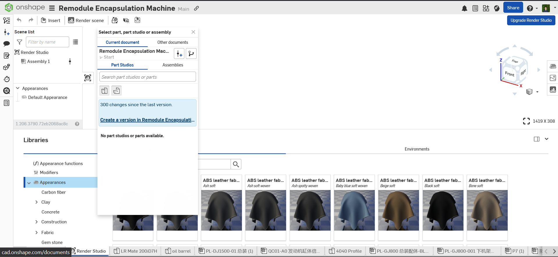

Render Studio Cannot Insert Parts, Only Finds Empty Assembly

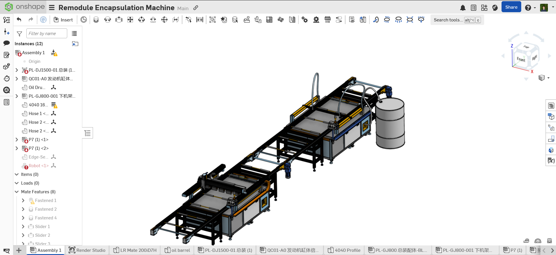

I am trying to render this machine my company is developing. As you can see the documents contains many part studios, which are put together into an assembly. So far so good. However, when I open the render studio, it tells me the document contains "no part studios or parts", and when I insert Assembly 1, it seems to be completely empty. Here's the document link: https://cad.onshape.com/documents/86d0790fc6e39976c865e512/w/5ca32ef909f16b3240c852a7/e/83786f482a130cef69c84678
  • GregBrownGregBrown Member, Onshape Employees, csevp, pcbaevp Posts: 404 image
    You need to refer to a version (that was created after you had created the assembly, of course)
    So just follow the instruction being given in the insert dialog —> "Create a version in Remodule Encapsulation"
