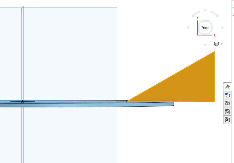

How to move the orange part to the left, so that the vertical edge is in sync with the edge of the round part underneath?
  • robert_scott_jr_
    By 'in sync', I think what you want to do is to fasten the triangle shaped part to the disc. This is done with an appropriately placed mate connector on each part and then a Fasten Mate to connect the two. - Scotty
