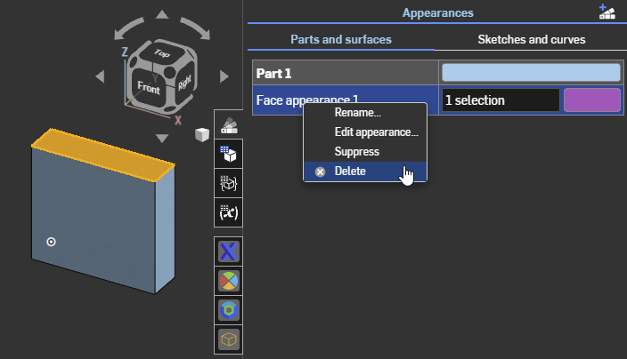

    I'm not aware of a "reset" options, but you can remove individual appearances like this:
