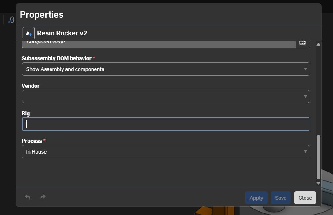

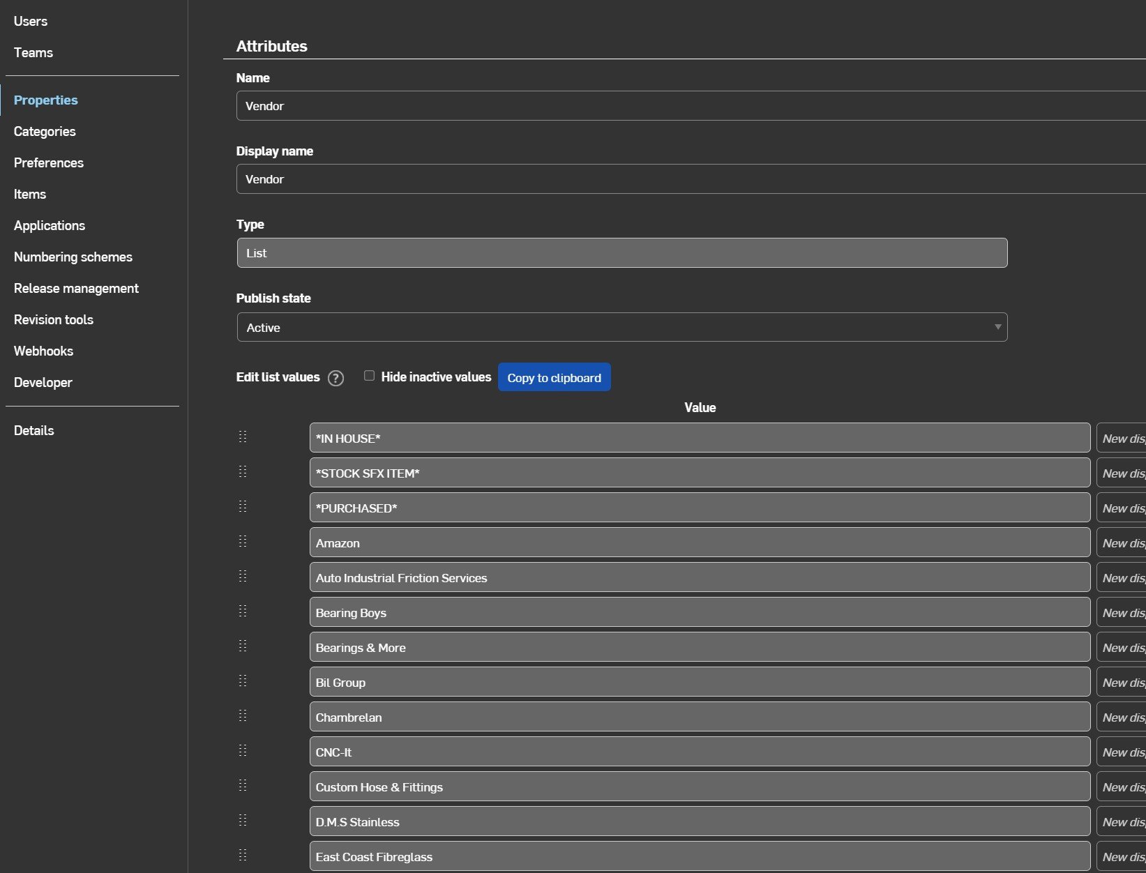

    I'm using the vendor property as above as these are persistent across all of my work. I wouldn't ever really want to remove any (inactive) but of course this is possible if one stops trading etc.
    I'm basically after a way to manage a list of projects which are available to me in a custom 'Rig' field when i'm filling out part/assembly properties. I'm trying to avoid a huge list in the attribute itself, like in 'Vendors'.
    I will be working on a project with multiple sub projects and jumping around a lot. Currently I'm typing it in and just trying to remember what I initially called the 'Rig' I'm working on! It's really just to get info onto drawings I issue that is consistent with the rest of the department.
    Ideally I don't want a master list to reference across my entire Onshape company (like vendors), because I could have 100s of entries in a few years… I want a list which is project specific, so when I choose 'Project 10' for example (as a property like vendor), the 'Rigs' field drop down updates accordingly, showing me what 'Rig' names I've assigned to that project.
