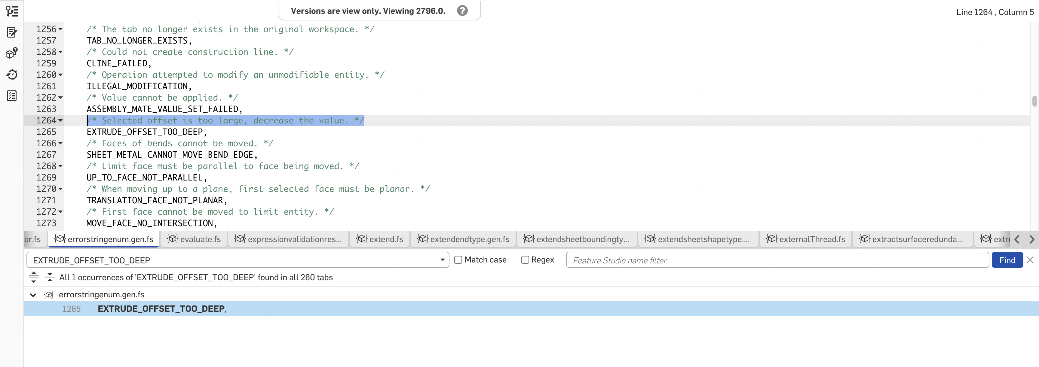

  • EvanReese
    I'm guessing you've somehow generated a length value that's hitting the limit of a part studio size. You can go to the standard library and hit "command + shift + f" (on mac) to bring up the super-duper find/replace tool which can search ALL of the tabs at once. Searching that error finds this.
