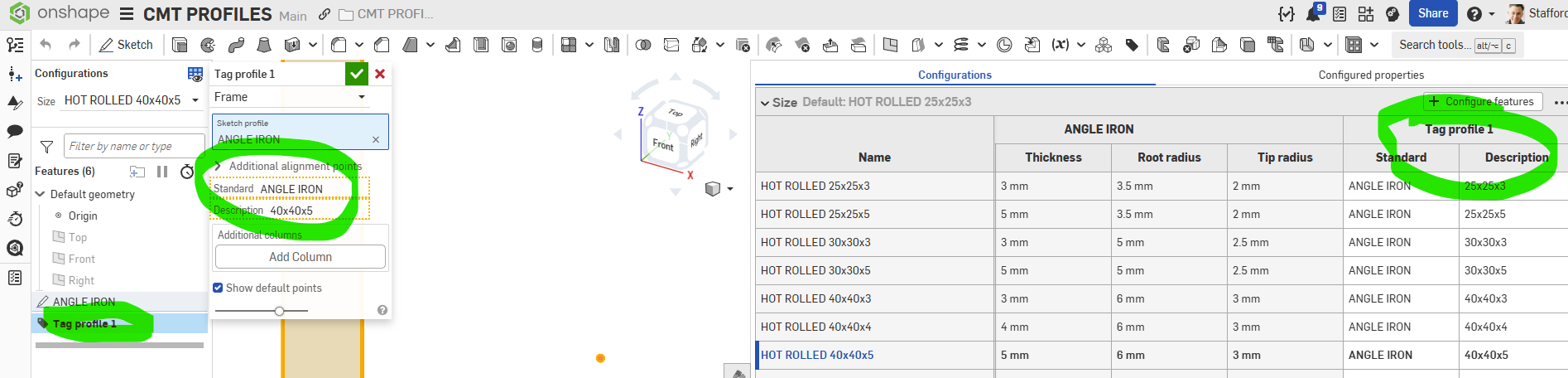

  • I've created a document with a number of tabs where each tab is a configured sketch of each of the profiles we use.
  • I've included the TAG information for each configuration and set the tag purpose to frame
  • I've versioned the document.
  • I've updated the frame library.
But I still can't get the standard and description to populate in the Cut list. Please can I ask for some help understanding what I'm missing.

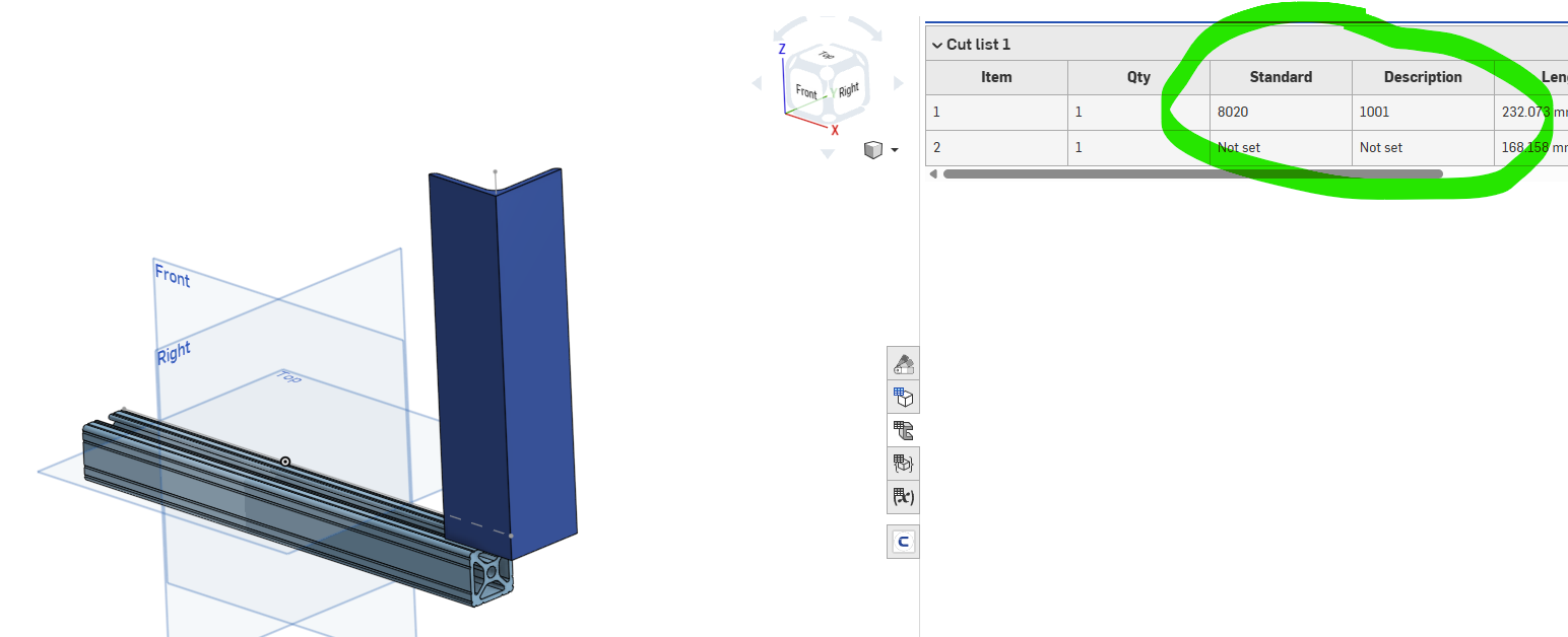

Here is a screenshot of the profile sketch
…and here is a screenshot of the cut list where you can see that the Standard and Description is blank for my custom profile.
I've since found that I can get the metadata to up date if unset the frame library and reset it. The update frame library does not seem to update the library!
