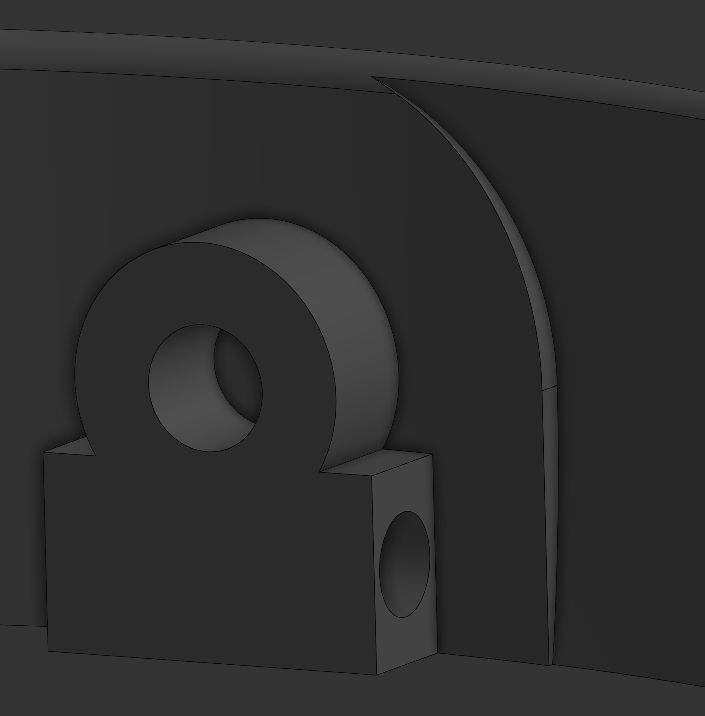

I am slowly getting the hang of surfacing! Here is a recent success I wanted to share, in the hope someone can point out how it can be done more efficiently or using different techniques. Because I kinda feel like I just lucked out this time.
(note: I would be even more hopelessly lost without the inestimable Onsherpa, @EvanReese. His recent video on advanced surfacing was a gold mine of information! Strong recommend!)
Recently I was modeling a household trash can, targeting FDM, and realized with the first prototype I didn't allow enough clearance for the lid to rotate. So I went back in and made some more aggressive cuts, which led to this fairly unsightly step in the model, which after some fussing around I managed to get blended in with tangent continuity.
Before | After |
I'm super curious to know how a professional user would tackle this problem. I seem to often hit cases like this, where I want to blend an edge down and need two surfaces rather than the single surface you can generate with a fillet or a face blend. The document is here and the folder with the specific steps is called "blend surfaces".

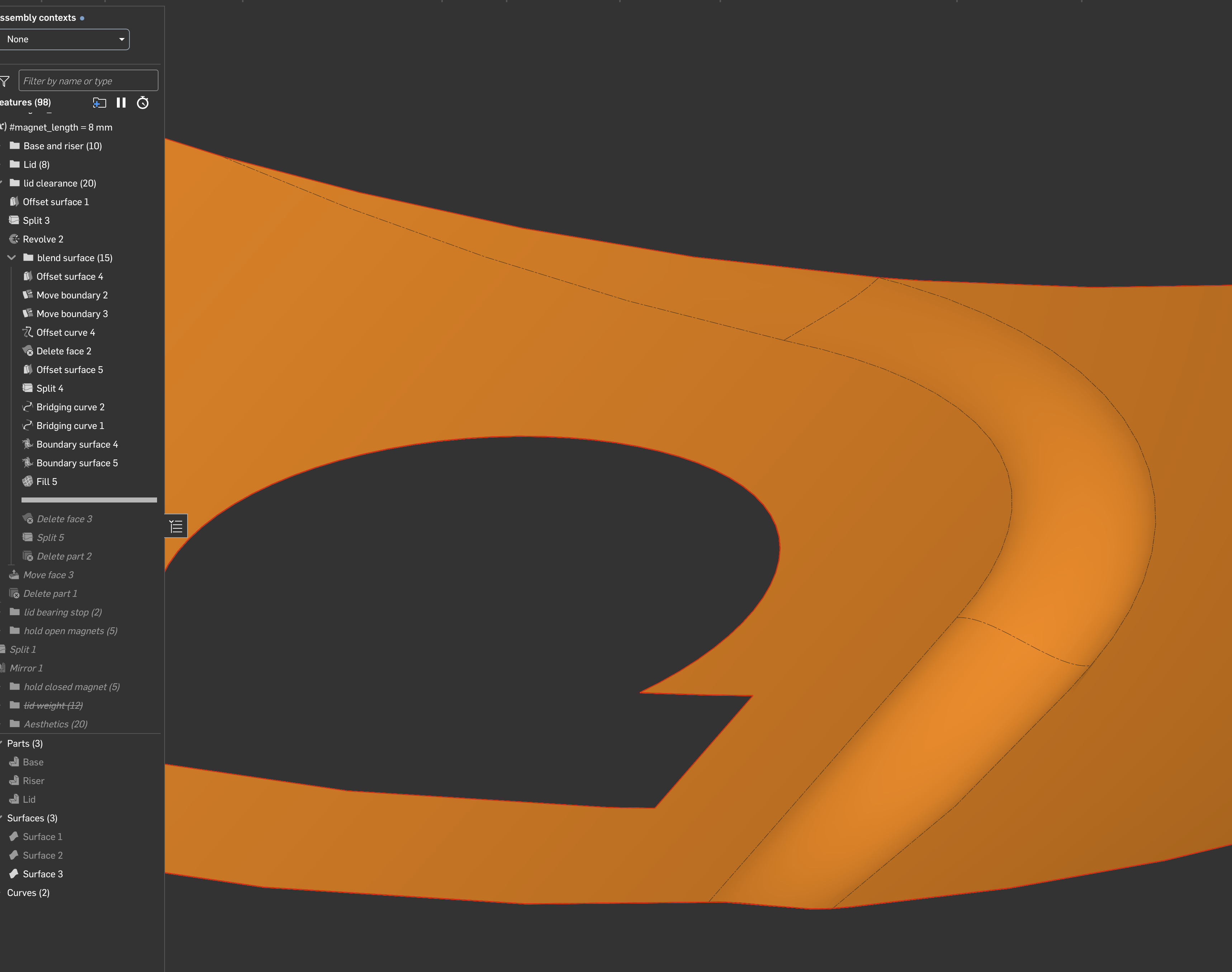

I think the core approach is probably standard: create surfaces for the start and end and bridge them with another face. What happens most of the time is that I end up trying random combinations of boundary surface and fills until one of them lets me pick "tangent" or better boundary conditions. Push buttons until angry red goes away.
Low quality surfaces | Profit! |

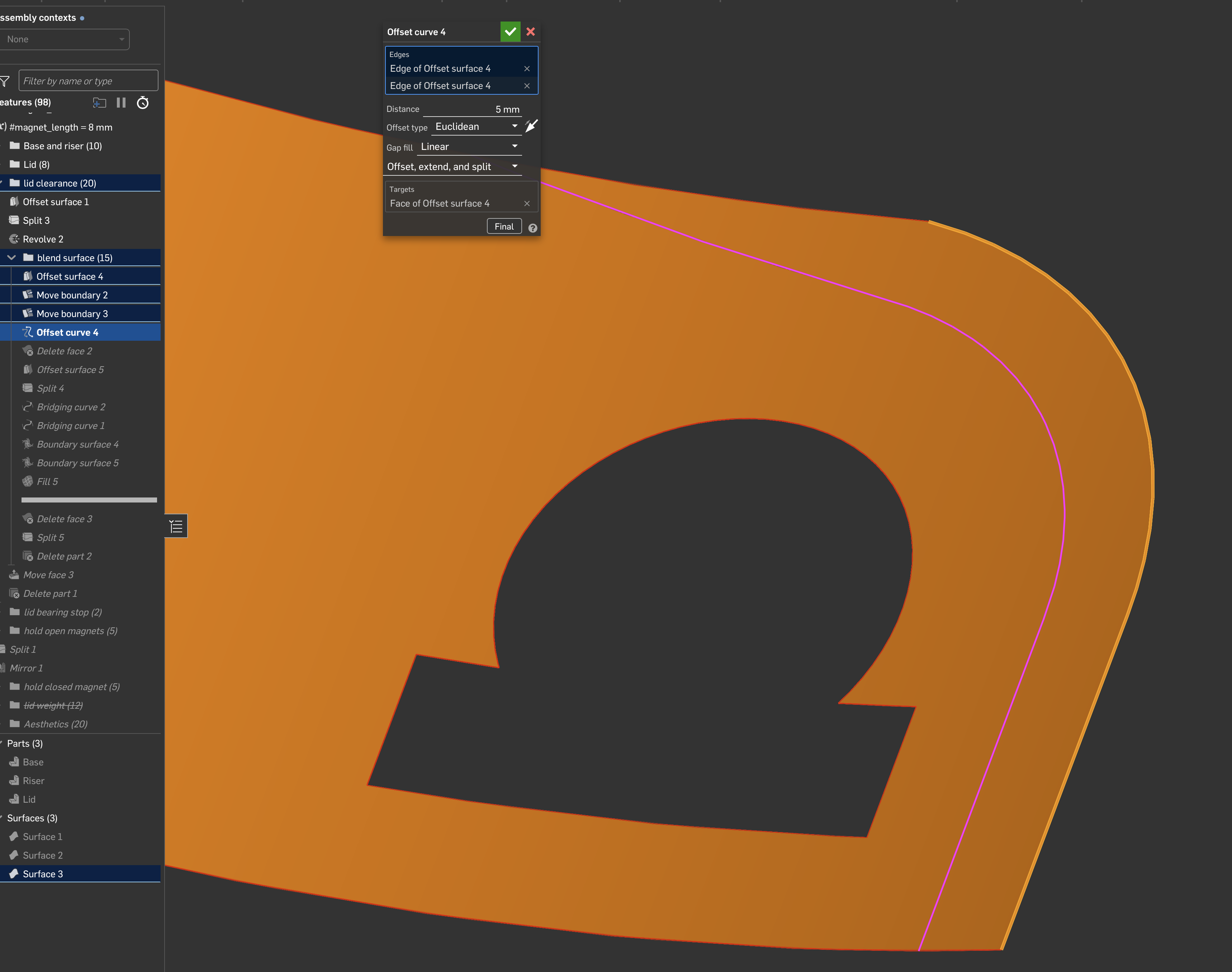

- Delineating the edges: I used offset curve because I heard projected curves tend to have a ton of control points that make things ugly. But how else might I have done it? I'm also a bit confused by projection direction, I seem to often struggle to get tangency after using one. I am dealing with a circular target, so what is the right direction? I already have an edge on the face I can use, so maybe offset curve was the right choice here?

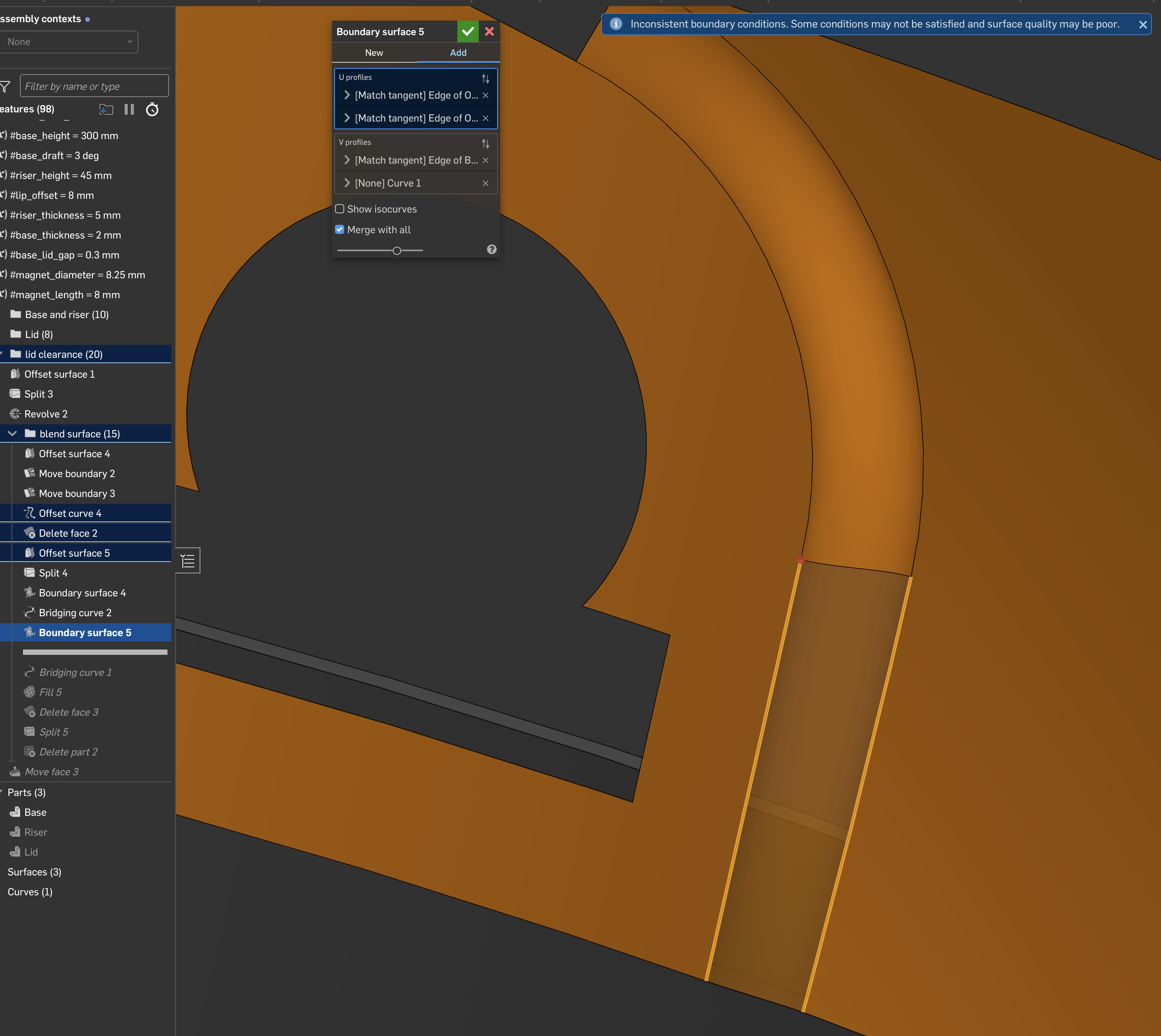

- Creating the surface: I could not get rid of the "inconsistent boundary conditions warning". Furthermore, I could not make the surface in one operation, I had to make each segment separately. These problems seem related but I couldn't figure out why.

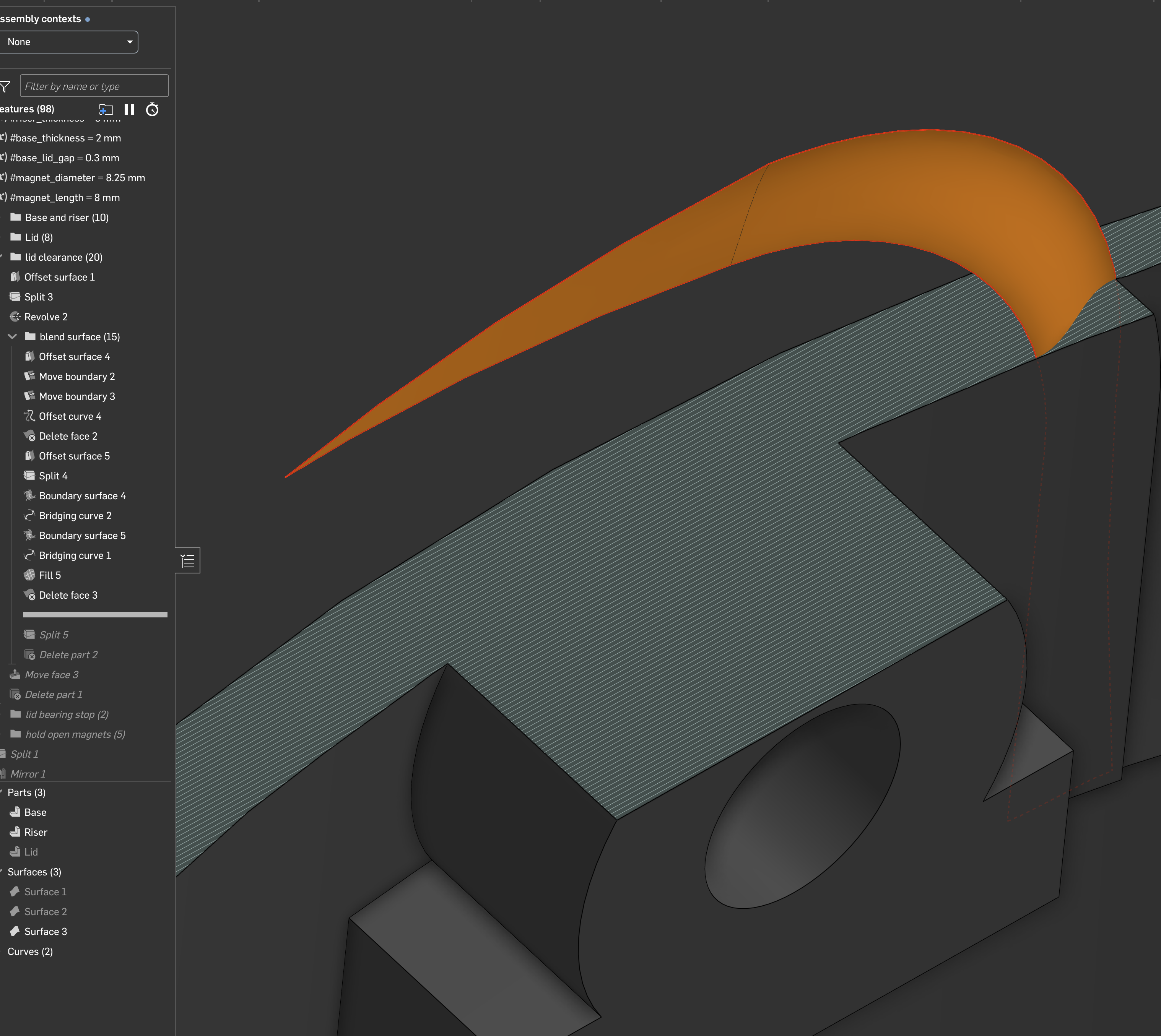

- Using the surface: It felt a bit weird for "split" to work successfully as the final operation, i.e. I was able to split the target part with the surface I built, and it all worked out because the tangencies lined up, making it purely subtractive. See the picture below. However this wouldn't have been fun if my surface needed to add something to the part. What do you do then?
Before settling on splitting / deleting I messed around with replace face, as it occurred to me that felt pretty logical. Split the faces on the original part, then replace those with the surface. However, it complained withsurface to replace with needs to extend the size of faceswhich I confess to not really understanding what it's trying to tell me. So I'm still a bit lost on how to handle this as a general case.
I thought I might have to do: split the target, delete the target face, then enclose to get a part back. I am fairly sure (?) that would have worked, but I was rolled back in the feature tree and I knew that would blow away all references to the original part, so didn't want to try it unless I got stuck.

Love that you're digging into surfacing! To be honest, this location on a product won't be seen, and it doesn't probably matter. Instead of surfacing this area, I'd probably just take the lid clearance face and continue it around the whole thing. But I still ended up getting sucked into it and made an impromptu video of my troubleshooting approach.
Thank you so much @EvanReese for taking the time to record this! Seeing experts work through the problem like this is incredibly valuable – if a bit nail biting when you're the author of the problem, lol.

nozzle_diameteras a variable. So I knew that crown on the top surface was going to be janky … but that too came about because I wasn't able to run a simple fillet or even chamfer around the top. Very likely those small artifacts getting in the way. Key lesson is definitely to roll back the tree and fix the root cause … in this case I had to resist the urge because I knew I'd redo the whole model from scratch if I started, and I'm not being paid to make trashcans ;) And I guess be vigilant for operations that leave little orphaned faces, probably a sign to stop and think.I was shocked when you deleted the face to reveal the degenerate looking geometry left behind from that revolve. That explains a lot! It must have been barely on the edge of self-intersecting. I didn't think much about it and assumed if it worked, it works. I wonder if there is a practice that can identify that, or some rule of thumb to learn? Something about off-axis revolves? Always check the curvature combs? I'm just somewhat surprised Onshape allowed it to be created in the first place.
