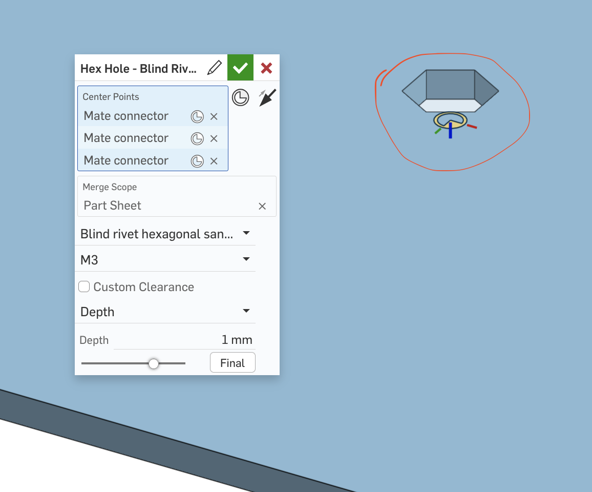

I wrote a FeatureScript to create specific hex holes for blind rivets.
Since we plan to use this feature frequently in our sheet metal parts,
I’d like to make the script as stable and robust as possible.
I would really appreciate it if someone could review my script and share any feedback or suggestions for improvement.
Here is the document:
https://cad.onshape.com/documents/93f0077f18ff8b011318c2cc/w/dbd112434bb6f64421cf964a/e/4e17803ab9feccb9b943e12f
Thank you!

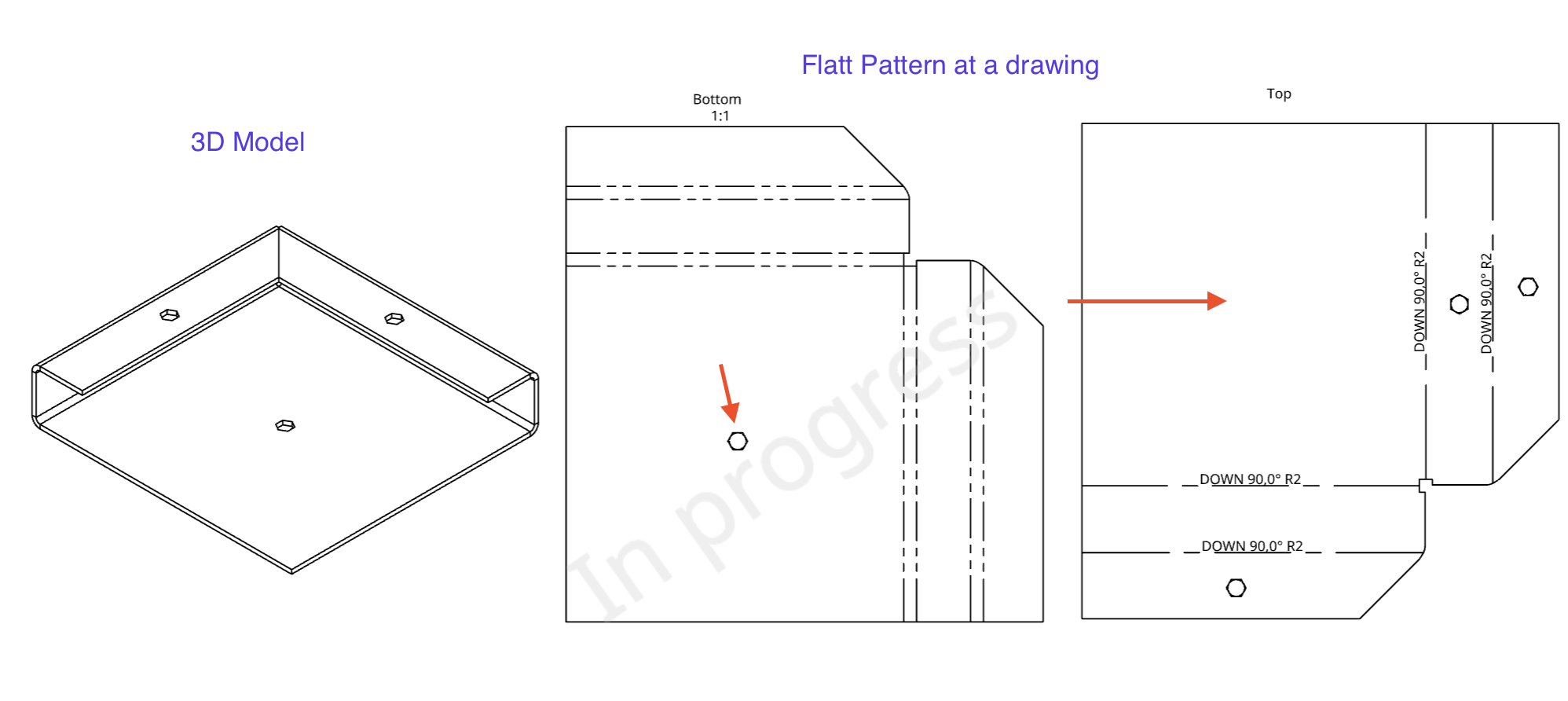

    The Form feature was also my first choice. It's really easy to create and configure.
    What limits us is that we sometimes also have normal bodies. These get the same holes.
    Also, ich oft I create the hey Jones with the form tool, the inputs need to be on the same side of the sheet every time. The holes are only visible on one side of the flat pattern in a drawing. Ist there a solution for that?
    As I understand it, the form tool can be used for stamping parts, but it will be a bit limited for laser cutting.
    S1mon Member Posts: 4,637 PRO
    Wow. I would file a bug about the drawings. I hadn't run into that.
    I can see that if you need this to work for regular parts as well as sheet metal that it makes sense to have your own custom feature.
