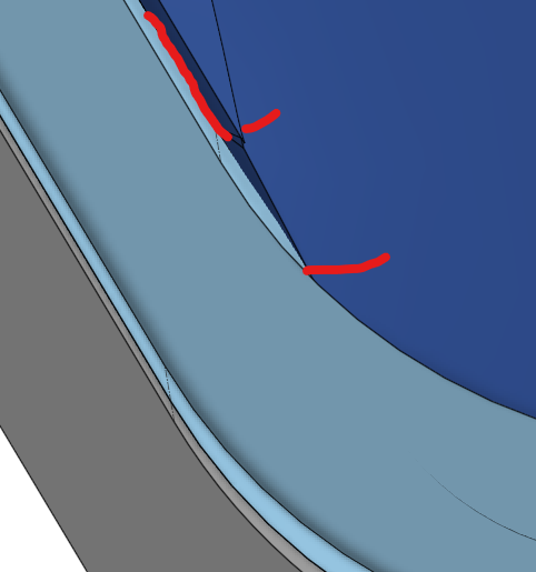

    that's because scs is not 3d printing your part They are CNC routing it out. so they need STEP file to do that. I looked at your file. I would spend some time with the replace face tool and boolean as a short cut to getting it to one piece. hindsight you should be using add when you create new features that will be part of the whole. if you can't get add to work boolean is not gonna work later down the road unless more geometry is added to join pieces together.
  • MDesign
    These are a couple things that are problematic as they create non-manifold geometry (zero thickness). This is a view of the underside in a corner.

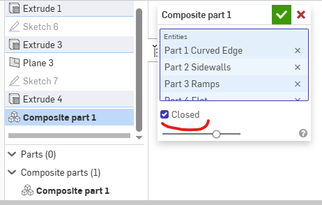

    Try selecting closed in the composite part.
  • john_mcclary
    john_mcclary Member, Developers Posts: 4,110 PRO
    All closed does in the composite part feature is delete the individual parts from the Parts List and make it a solid color. It also prevents you from controlling the individual parts independently.
    The composite part is always treated as a grouping of parts, or a multi-body part if you want to use SolidWorks lingo. So, the step file looks the same as if it were multiple parts anyways.
    If you want to have it import into other cad/cam systems as a single part, then you need to use Boolean→Union
    in order for Boolean to work, you will need to fill your gaps, so the parts are touching or intersecting. See @MDesign's comment about non-manifold geometry

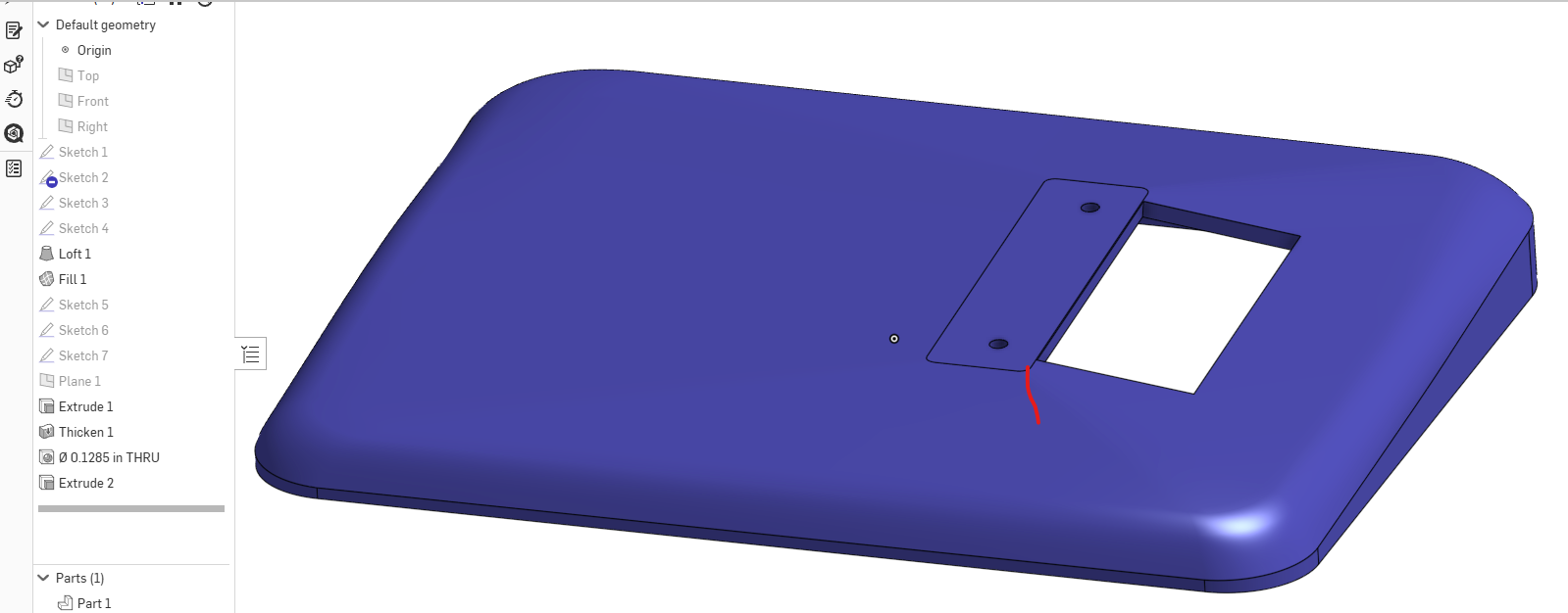

    When I first looked i thought maybe an import base on the look and multiple parts. Was obviously mistaken. Here is a version that may help to understand the problems. There are piecemeal parts because edges don't come together to make one part when something new is added. The overall method is quite piecemeal. You may want t look into use of mate connectors when starting sketches with less planes in the feature list. I did add a plane to provide the sloped bottom since extrude can be to face which allows selection of a plane as the cutoff. Also put some small radiuses to make the loft much simpler. I worked in surfaces and thickened the whole thing. I wouldn't think using solids and shelling would not be to much different. Just my preference.
    This came out as 1 part instead of a few and can be exported in any of the above mentioned formats as a single part with out the problems you're you've been having. Boolean and composite parts aren't likely to get what you want because of gaps.
    https://cad.onshape.com/documents/41c8397bd9b850eba131f054/w/77fddf1b724254b6cf8e12c5/e/2bca716d24ffa92a97735a54
