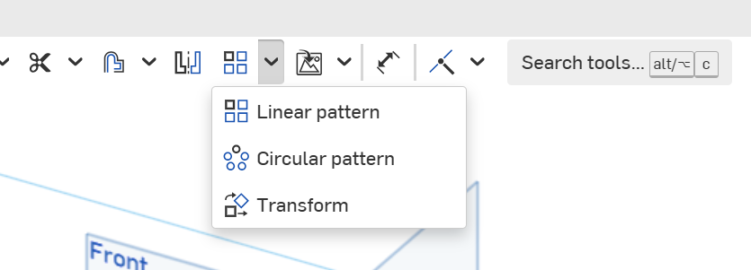

    Hello and welcome to Onshape. Use the Transform tool to rotate and/or move the imported image. - Scotty
