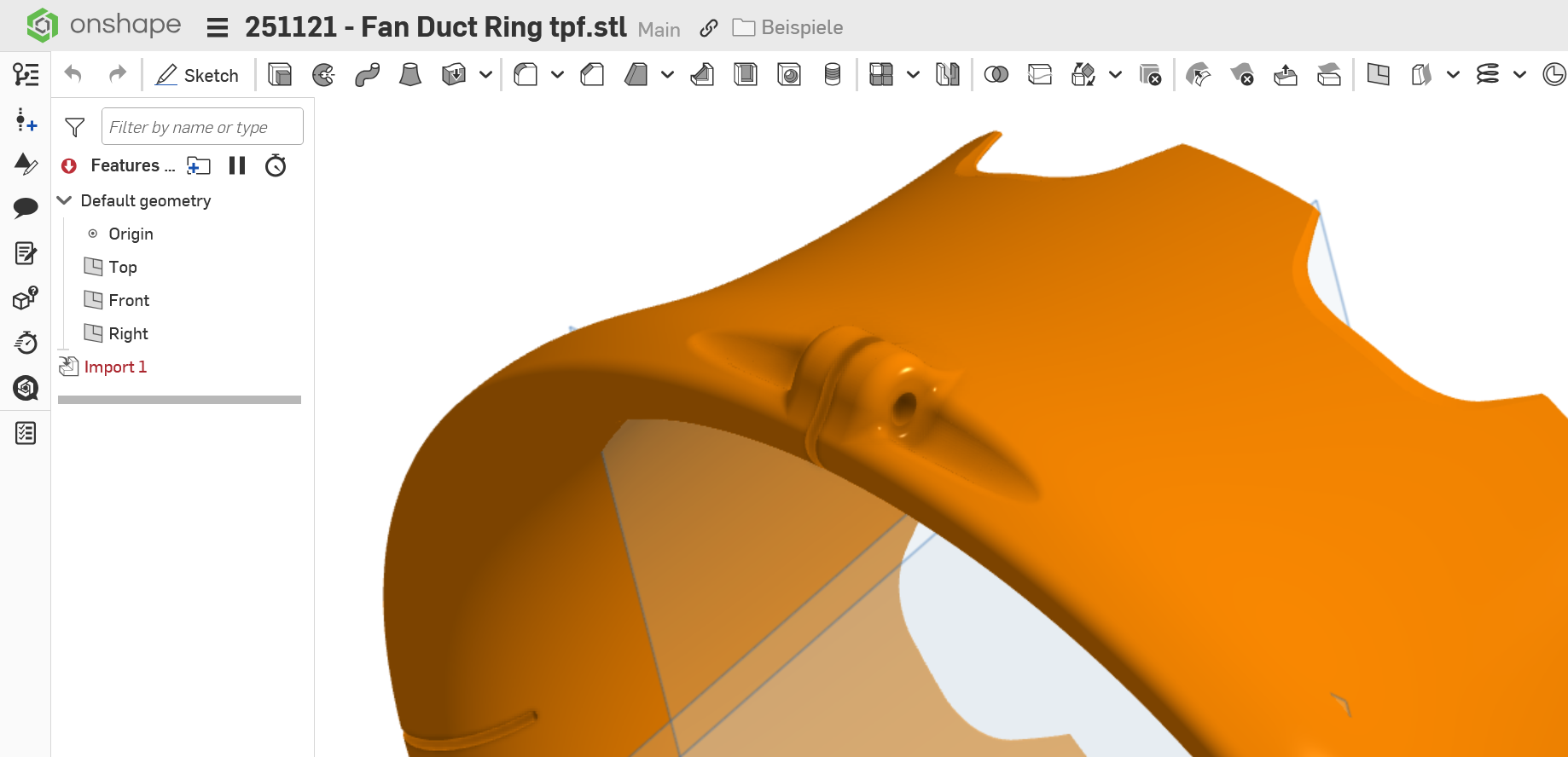

How do I remove all these (Faces?) from imported models
I'm still kind of new to
Onshape, please help me fix this.

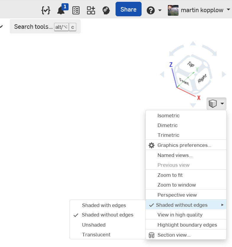

If you're only after a cosmetic solution, by just not showing the faces, you can switch the face edges off:
This will be the difference:

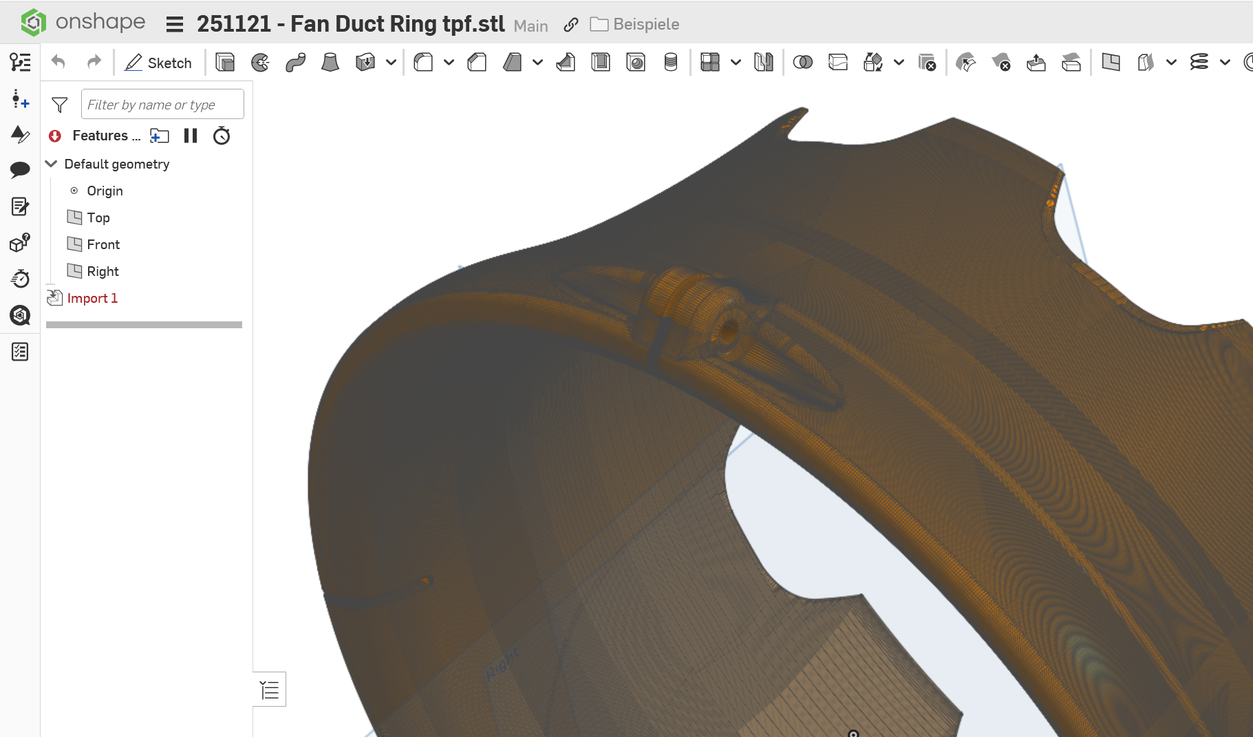

Before, with really a lot of faces ….

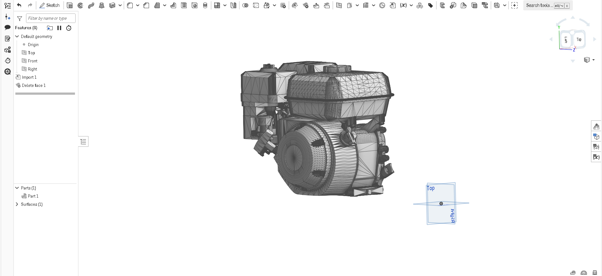

… and after:
The faces will still be there, though.
