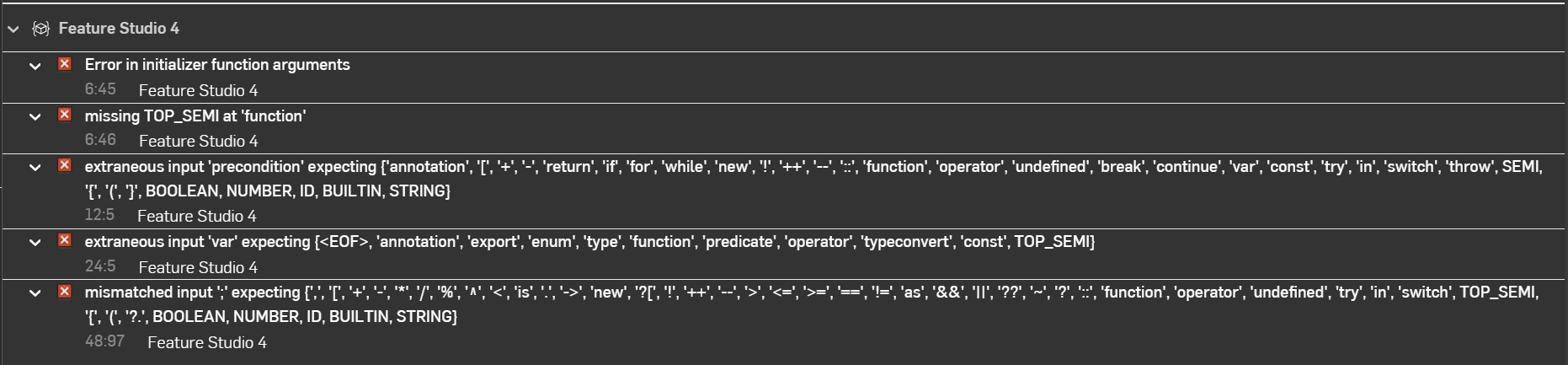

Can someone please assist in helping me correct my fs code.

I don't seem to understand what I am doing wrong these are the errors I am getting.
this fs will be used to reference certain things from a configuration table and turn that info into a custom table for me so I can insert that table into a drawing.
  • jelte_steur_info
    one thing:
    // 1. Add preferred keys that exist in the data
    for (var i = 0; i < size(PREFERRED_KEYS); i++)
    i += 1
    then there's something wrong with the precondition definition. But i haven't programmed tables before so i'm not sure what.
    BUT if you add
    precondition{} before the function block, and comment out the existing precondition line,
    There are still a bunch of functions that aren't recognised…
