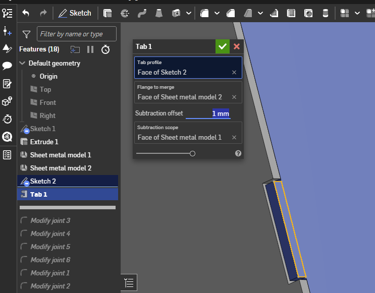

I am working on a sheet metal design for a steel construction and I am stuck on a specific workflow issue regarding self-fixturing tabs.
My Workflow:
  1. I start with a master sketch and create a solid Extrude.
  2. I use "Convert to Sheet Metal" to turn the solid into individual sheet metal parts.
The Problem:The conversion creates a small relief gap between the parts. I now want to create positioning tabs (tabs and slots) between these adjacent plates.
  • The standard Sheet Metal "Tab" tool doesn't seem to support connecting separate parts across a gap.
  • Custom Features (like Laser Joint) fail because the parts do not physically touch or intersect due to the relief gap created by the conversion.
My Constraints:I want to avoid "hacking" the geometry with Move Face or Direct Editing to bridge the gap manually, as I want to keep the model parametric and clean based on the master extrude.
Question:What is the proper workflow to generate tabs/slots between parts that have been created via "Convert to Sheet Metal"? Is there a setting in the Convert feature I am missing, or a standard method to bridge this gap for tab generation?
https://cad.onshape.com/documents/4f1fe5fcdd6a13e6ca934728/w/5442b6332d503b25cb6b46bd/e/c0aac806da9de0e1f2ed2a22
Thanks in advance!
  • eric_pestyeric_pesty Member, pcbaevp Posts: 2,497 PRO
    I think there's a limitation on the tabs when multiple parts are created in the same sheet metal feature.
    It works fine if you use two separate features:
    Also, "move face" is not a "hack", it's an integral part of the workflow in Onshape sheet metal, and if you use "up to" (with or without offsets), it remains parametric and is actually a really good way to capture design intent.
