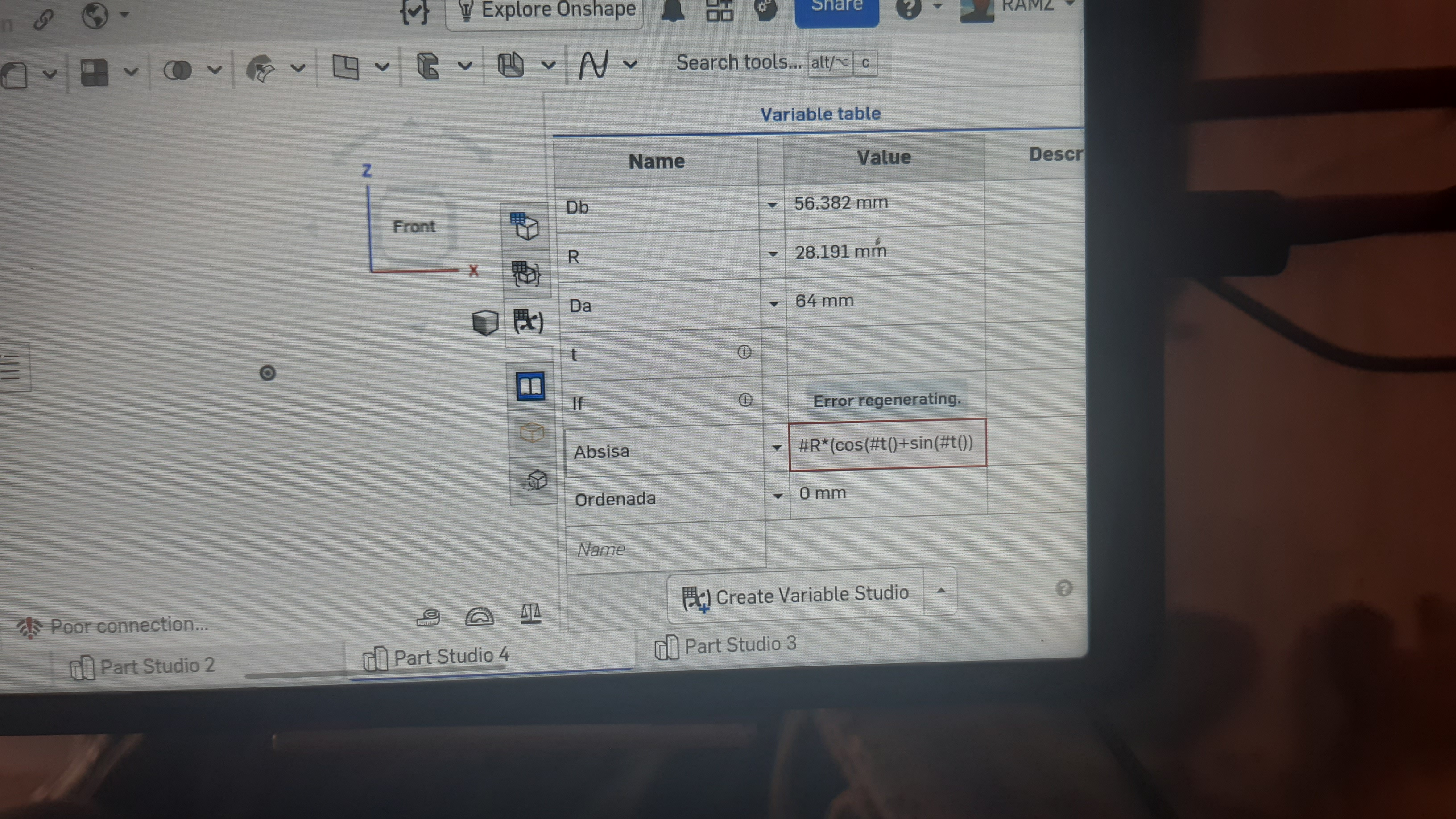

Hello, I'm an amateur designer using the Onshape platform with very good results so far, I must admit. However, I've recently run into a problem I can't solve. I'm trying to generate an involute profile, and when I load the data, I get an error message. To explain, when I write the equations for X and Y, I get the error shown in the attached image. How should I load the data?

    Just a shot in the dark, but it looks like the formula for absisa is missing some matching right parentheses - could that be the problem?

    Maybe it's possible, I'll gonna check this, thanksthan for your support
